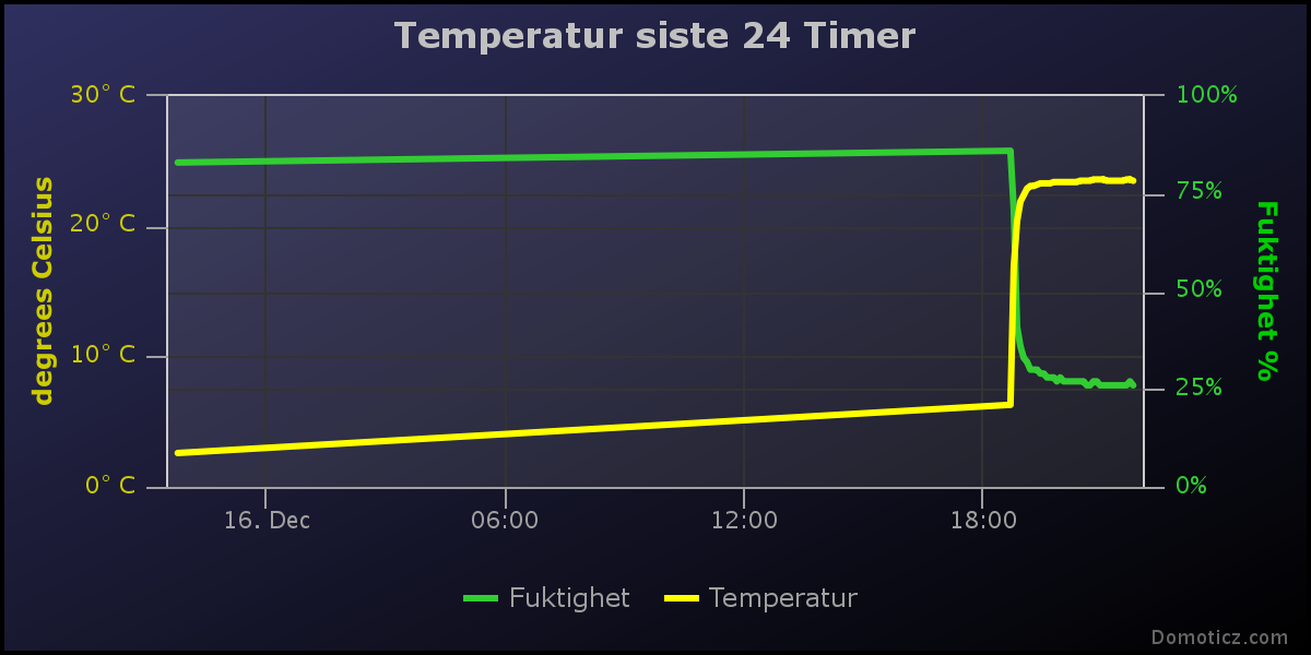

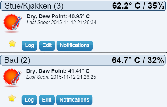

Received in the mail today, mine is also inaccurate by "a few degrees" :lol:
Uten navn.png (44.37 KiB) Viewed 10056 times
going to buy me a regular thermometer and calibrate

Readings show slightly lower than normal human body temperature. If you were sitting on them at the time they seem to be working really well :lol:

dont forget that this is celsius ;)
PS: I tried to put one in the refrigerator and it turned colder, also I tried to take a shower and the humidity increased.
So pretty sure it's just a calibration I need.

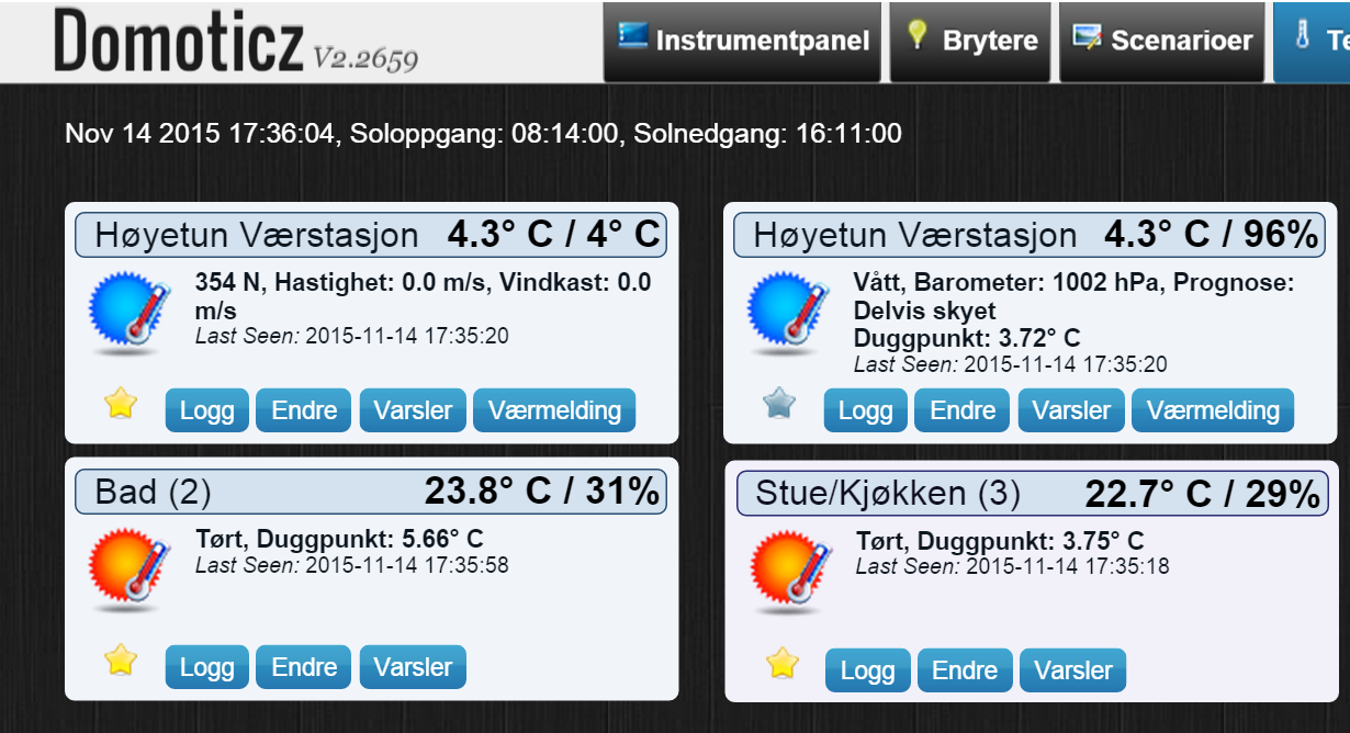

Post by Evelen »
calibrated, works ok

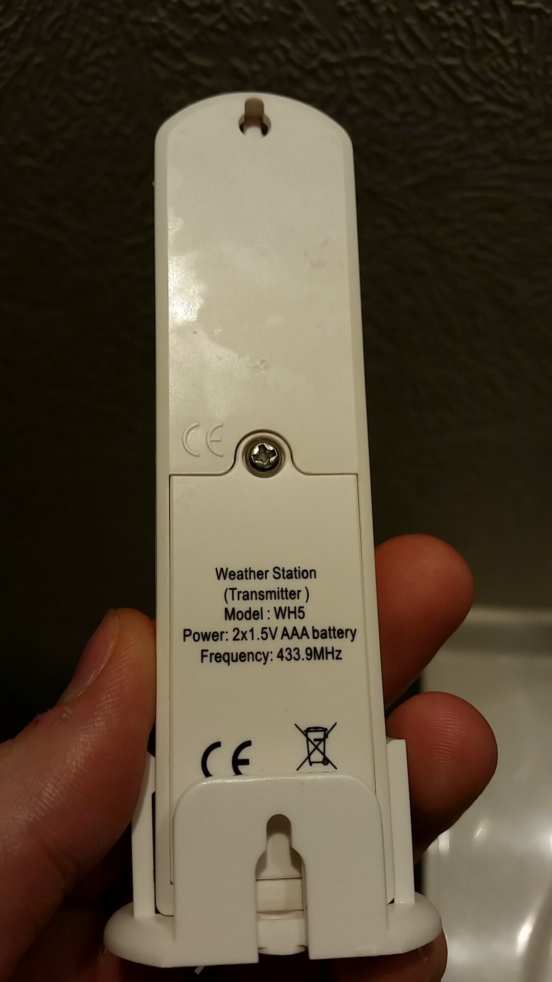

I received 4 sensors last week, which look really the same (with Imagintronix printed on the front) . The model is wh-5. Behavior is the same, roughly 40 degrees to high. Humidity looks alright though.
Today I've tried new beta firmware (version 249) for thr RFXtrx433-ext, but no improvement.
Maybe this link can help (looks the same device): https://www.pitt-pladdy.com/blog/_20131 ... for_WH1400_

Mine is also WH5
idk if it is the same device, probably I think.

I received one of these devices today (along with my RFXtrx433E). The RFXtrx433E is up and running (connected to a couple of LightwaveRF devices and my Energenie plug sockets) but I cannot get it to pair with the themometer. It's a WH5 device as shown below, I've put the batteries in and enabled the FineOffSet/Viking protocol, am running the latest firmware (1007) and have put the device right next to the RFXtrx433E but it will not pair.
What am I missing?
