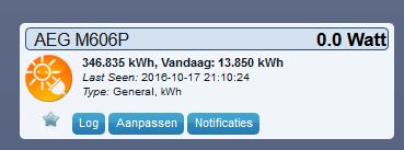

I am reading and trying and do more reading and trying and so on. I'm now busy with frontpage and I would love to see the moon phase in my frontpage skin.
I there a posibitly to make a virtual device or something like that, to show the moonphases in the frontpage?
I would also like to see my total ammount of kWh of my solar panels.
The IDX from the panels is: 1825
The commands I use are
['1825','CounterToday', 'cell4', 'Elektra vandaag (kWh)','0','0'], --> returns a value
['1825','Usage', 'cell5', 'Actuele opwek (Watt)','0','0'], --> returns a value
I've tried
['1825','Counter', 'cell10', 'Elektra','1','0'],
['1825','CounterTotal', 'cell10', 'Elektra','1','0'],
And more.... unfortunatly it doesn't return the total value.
Can somebody help me please

In the javascript part you could load a different image for the moon depending on the moonphase.
For the counters,
I use for total Mwh: 'Data', I also use CounterToday and Usage.
If you issue the json command used in the frontpage code, you see all the fields present in a certain switch (etc). You can see there what to use.

For the counters,
It worked like a charm, Thanks Jannl
however I still would like to implement the moonphases. I can adapt a picture, but therefore I need to implement the code for moon phases times for moon up and moon down.
Is it possible?
