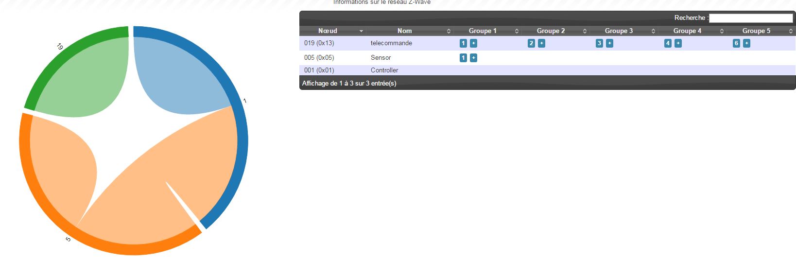

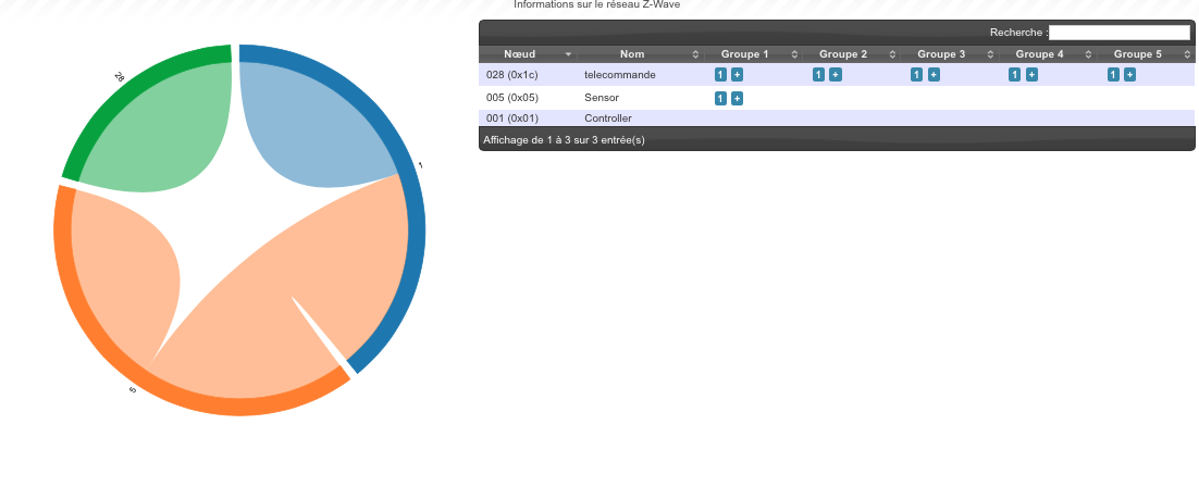

Did you connect the association groups?
There are 5 of them.
<Associations num_groups="5">
      <Group index="1" label="ZWave Plus Lifeline" max_associations="10" auto="true" />
      <Group index="2" label="Controlled by button 1 or single clicks of buttons 1 and 3" max_associations="10" />
      <Group index="3" label="Controlled by button 3 or double clicks of buttons 1 and 3" max_associations="10" />
      <Group index="4" label="Controlled by button 2 or single clicks of buttons 2 and 4" max_associations="10" />
      <Group index="5" label="Controlled by button 4 or double clicks of buttons 2 and 4" max_associations="10" />
    </Associations>
Go to Nodes, Node Management, Group & Network.
Group 1 needs a connection with your controller (number 1)
Try 1 or 1.1 for Group 2 up to 5. The Domoticz can handle your 4 remote control buttons.
You can add a direct connection between the remote and another Z-wave Node, by adding it's Node number (sometimes as xx.1)
Please take a picture of that.

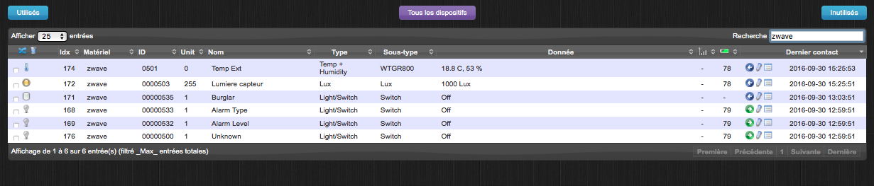

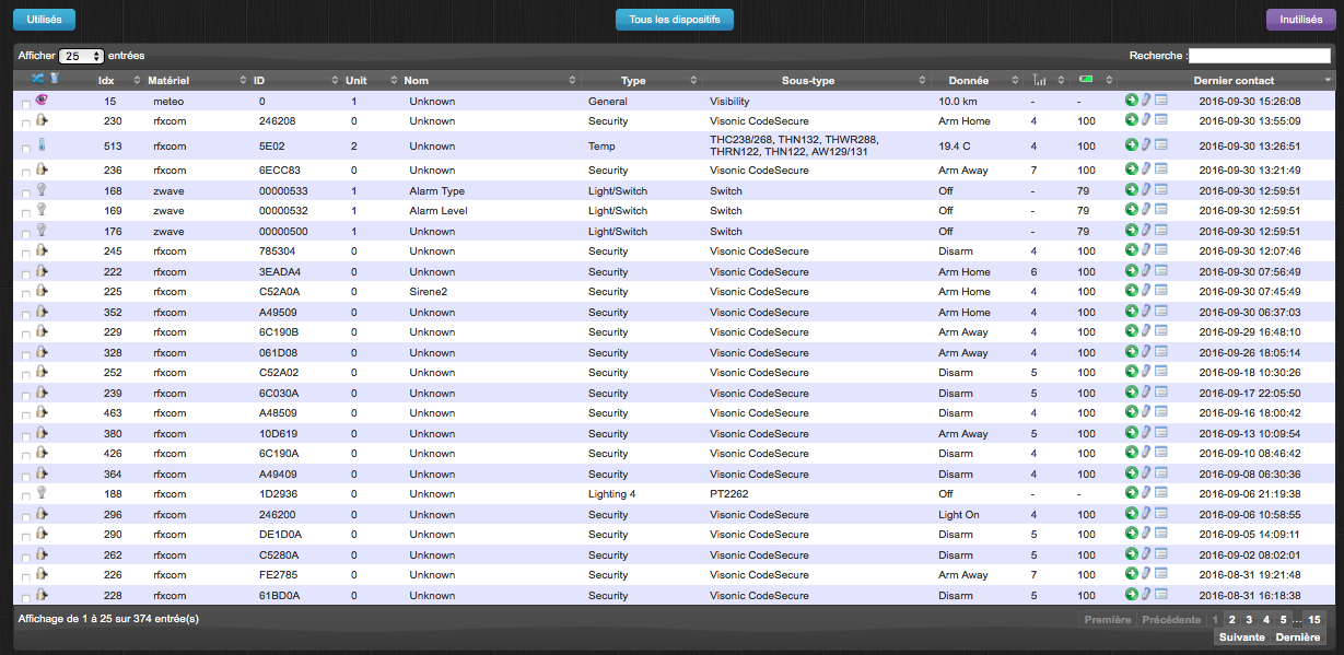

Go to Devices, filter on 0D (zero D, the HEX value of Node 13) or unused devices.

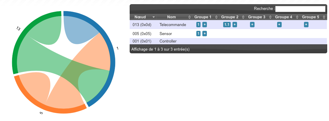

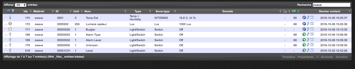

fennec62
Posts: 43
Joined: Sunday 26 October 2014 22:11
Location: france
Re: remote Zwave Devolo MT2653
Post by fennec62 »
Thanks for your help
I have no experience with node ...
Capture d’écran 2016-09-28 à 08.26.50.png (239.79 KiB) Viewed 6731 times
Capture d’écran 2016-09-28 à 08.27.09.png (69.68 KiB) Viewed 6731 times
Domosapiens
Posts: 232
Domoticz version: V3.5981
Post by Domosapiens »

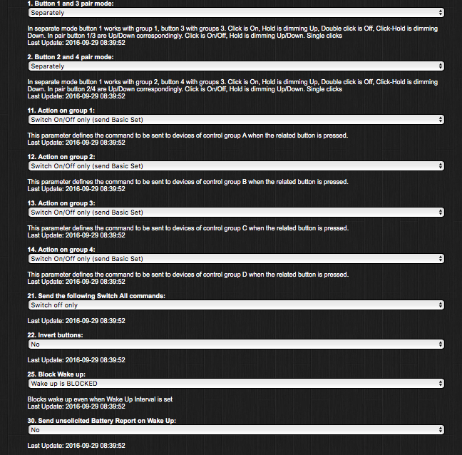

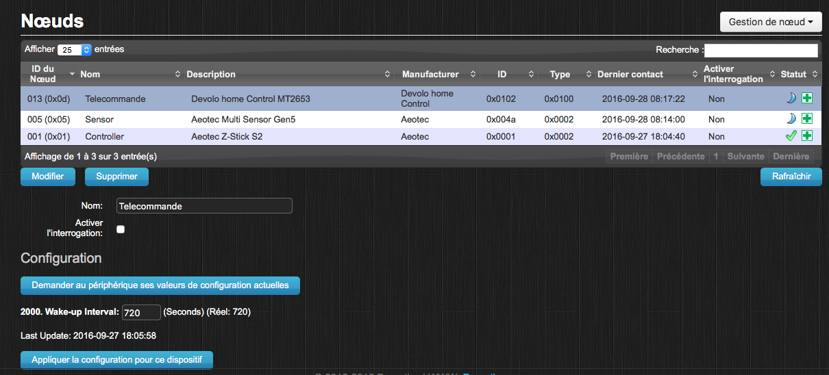

First things first.
It seems that your mt022653.xml is not in effect,
because ...
All text after
<Help>
should be visible in the MT2653 Node configuration screen
and there should be selection possibilities.
this is caused by ....
Syntax errors in your mt002653.xml file
(according to your code piece in my XML editor)
Use an XML editor to solve the syntax errors.
Check also your manufacturer_specific.xml on errors
then ...
Stop Domoticz.
Edit you zwcfg_0xzzzzzzzz.xml file (copy it first)
Remove the section related to Node 013
Save the file.
Restart Domoticz.
Then in the configuration part of MT2653 you should see a number of configuration options with help text.
Hope this helps

Ok thanks a lot
So XML is bad i make new
<?xml version="1.0" encoding="utf-8"?>
<Product xmlns="http://code.google.com/p/open-zwave/">
  <!-- Configuration Parameters -->
  <CommandClass id="112">
    <Value genre="config" instance="1" index="1" value="1" label="Button 1 and 3 pair mode" units="" size="1" min="0" max="255" type="list">
    <Help>
In separate mode button 1 works with group 1, button 3 with groups 3. Click is On, Hold is dimming Up, Double click is Off, Click-Hold is dimming Down. In pair button 1/3 are Up/Down correspondingly. Click is On/Off, Hold is dimming Up/Down. Single clicks
  </Help>
      <Item value="0" label="Separately"/>
      <Item value="1" label="In pair without double clicks"/>
      <Item value="2" label="In pair with double clicks"/>
 </Value>
    <Value genre="config" instance="1" index="2" value="1" label="Button 2 and 4 pair mode" units="" size="1" min="0" max="255" type="list">
    <Help>
In separate mode button 1 works with group 2, button 4 with groups 3. Click is On, Hold is dimming Up, Double click is Off, Click-Hold is dimming Down. In pair button 2/4 are Up/Down correspondingly. Click is On/Off, Hold is dimming Up/Down. Single clicks
  </Help>
    </Value>
    <Value genre="config" instance="1" index="11" value="1" label="Action on group 1" units="" size="1" min="0" max="255" type="list">
    <Help>
This parameter defines the command to be sent to devices of control group A when the related button is pressed.
  </Help>
      <Item value="0" label="Disabled"/>
      <Item value="1" label="Switch On/Off and Dim (send Basic Set and Switch Multilevel)"/>
      <Item value="2" label="Switch On/Off only (send Basic Set)"/>
      <Item value="3" label="Switch all"/>
      <Item value="4" label="Send Scenes"/>
      <Item value="5" label="Send Preconfigured Scenes"/>
      <Item value="6" label="Control devices in proximity"/>

And now config in domoticz is ok
Capture d’écran 2016-09-29 à 08.56.10.png (215.29 KiB) Viewed 6705 times
But i can't see a button in domoticz
Capture d’écran 2016-09-29 à 08.56.29.png (56.61 KiB) Viewed 6705 times
I don't have another zwave control device
I just wan't have a on off switch association with button on remote

Big steps fennec62!
I would use 1.1 for Group 3, 4 and 5 also (don't know the effect of 1.2, 1.3 and 1.4)
Is the green line Node 018?
Is it sleeping? It seems not connected to 001 (your controller).

No new device
This is all new device
Capture d’écran 2016-09-30 à 15.38.56.png (263.94 KiB) Viewed 6639 times
Capture d’écran 2016-09-30 à 15.39.55.png (101.17 KiB) Viewed 6639 times
Domosapiens
Posts: 232
As number for a Group, you can only use Z-Wave devices, or your controller.
Wake-up your remote. How ? See the manual (and scan it!)
While awake fill for all groups 1 or 1.1 to direct the signal to Domoticz Z-Wave controller.
Capture d’écran 2016-10-06 à 15.31.51.png (96.62 KiB) Viewed 6571 times
Capture d’écran 2016-10-06 à 15.32.10.png (277.25 KiB) Viewed 6571 times
Capture d’écran 2016-10-06 à 15.32.23.png (62.05 KiB) Viewed 6571 times
just one device
But no log when i push button
If someone have a idea thanks a lot
Association,
you need to associate the 4 buttons with other Z-Wave devices,
in your case: with your Controller (Node 1)
Try to add 1.1 to group 2,3,4 and 5 (Group 1 is the lifeline for Node 1).
Use the + sign and add 1.1
(it could be that only 1, as you have now is enough, but give it a try)

Try to un-block Wake up parameter 25 (temporary)
