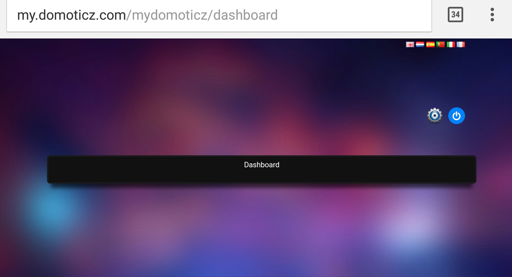

:idea: The problem with the dashboard.
If I choose a floor plan as the dashboard mode (normal, compact, mobile and floorplan options) in the Domoticz settings, in the upper menu the button "Floorplan" (between Dashboard and Switches) disappears and the link http://192.168.1.5:8080/#/Dashboard doesn't exist. When I click on "Dashboard", the address is "http://192.168.1.5:8080/#/Floorplans" not "http://192.168.1.5:8080/#/Dashboard". I prefer this, because floorplan is my favourite.
In this case, trying to connect from my.domoticz.com to local domoticz server by pressing the green man icon is impossible. This is because mydomoticz tries to connect with "https://my.domoticz.com/mydomoticz/dashboard#Floorplans".
In case, when the dashboard in domoticz is different than floorplan, when I click green man icon in mydomoticz, it connects with address "https://my.domoticz.com/my/3...4/#/Dashboard" and all works fine.
Please fix it, thanks.

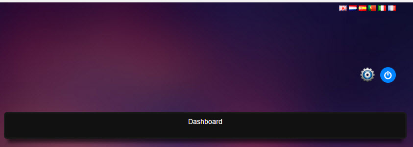

I register on Domiticz.com, filled all field in my Domitcz but my boad stay clear and I have this message in the Log:
PROXY: Connect failed, reconnecting: Connection timed out
And MyDomoticz Instance ID: (none)
Any Idea to help me

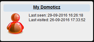

i have installed domoticz on my raspberry pi. Works all good. After that, i followed the steps from http://domoticz.com/wiki/MyDomoticz and that also worked.
Unfortunately, i removed the instance from my dashboard, but probably when Domoticz was connected. Now, i can log in but i see only a empty dashboard. I cant find out how to repair / reset this to get mydomoticz get worked again. Can someone tell me how to fix this or where i can find the information to do this?
Many thx, Marcel

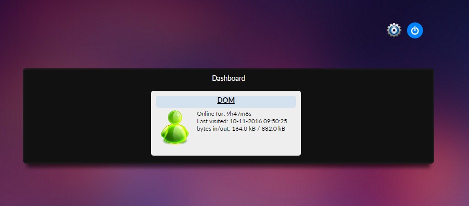

hello.
Yesterday i've updated Domoticz on RPI with ./updaterelease;
finally domoticz instance came up in MyDomoticz.
But when i click on green icon it shows background of my domoticz, then returns to instances list.
Unfortunately i cant see now the log file, maybe in the evening.
OK the message was "browser cache failed" and login dialog wont appear.
When i change it to Firefox everything works fine!!!
THANKS!!!!!!!

Re: The problem with the dashboard [how to fix]
Post by chimit »
ArturK wrote::idea: The problem with the dashboard.
Could you post this here? https://github.com/domoticz/mydomoticz/issues
