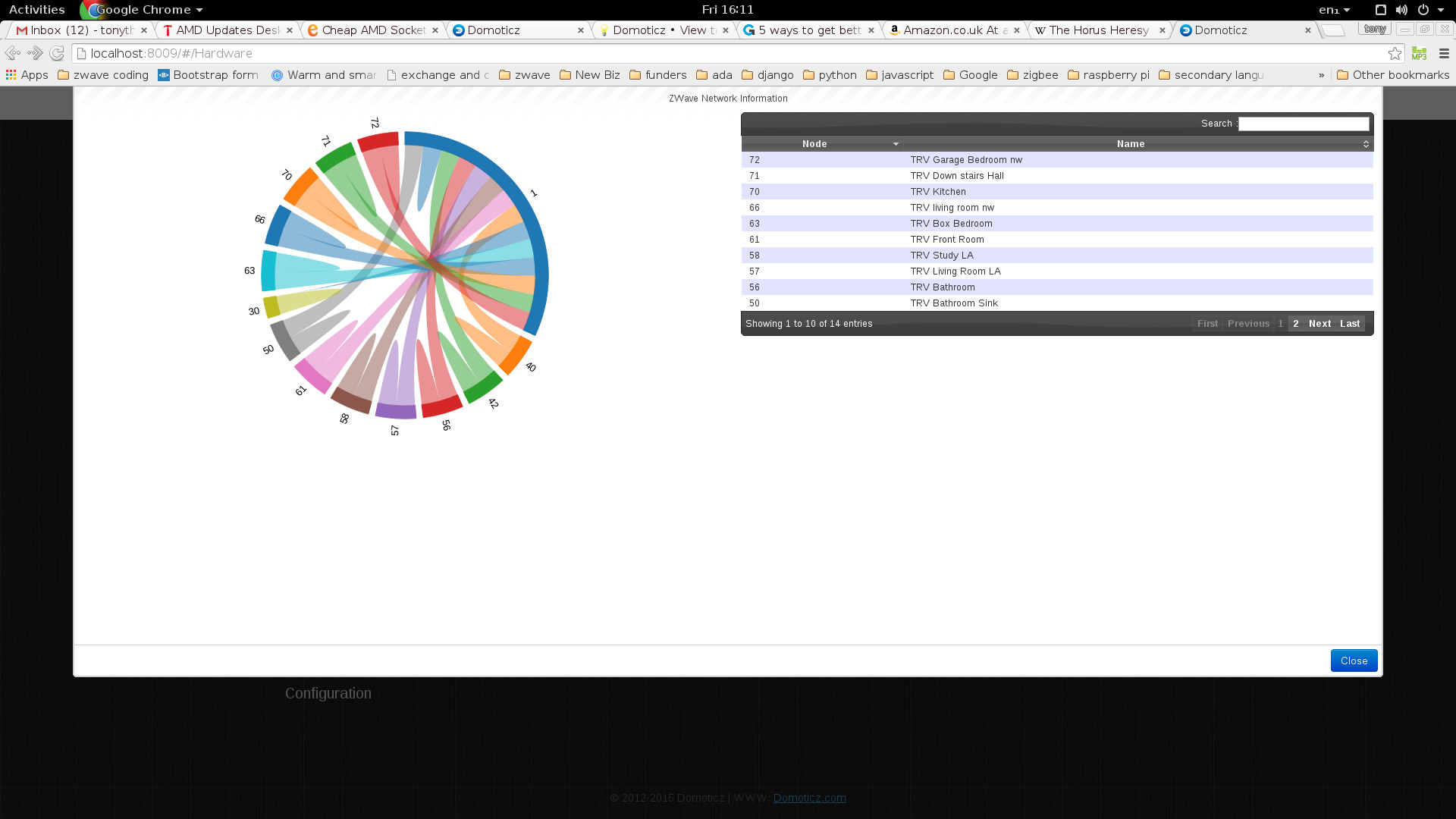

You have used the Aeon stick to include your nodes? Please post a screenshot of your network and groups similar to this one:

Heres the screen shot of my groups and network screen

Strange, non of your nodes connects to anyone else then the controller. What kind of hardware is it?
Are they so thermostats?
/lennart
sidepipe
Posts: 30
Joined: Wednesday 18 February 2015 12:48
Re: Zwave and groups -> how does it work?
Post by sidepipe »
My guess, from the screenshot, is that they're TRVs :)
In which case it's perfectly normal that they don't have associations. They will just report to the controller at every "wake up interval."

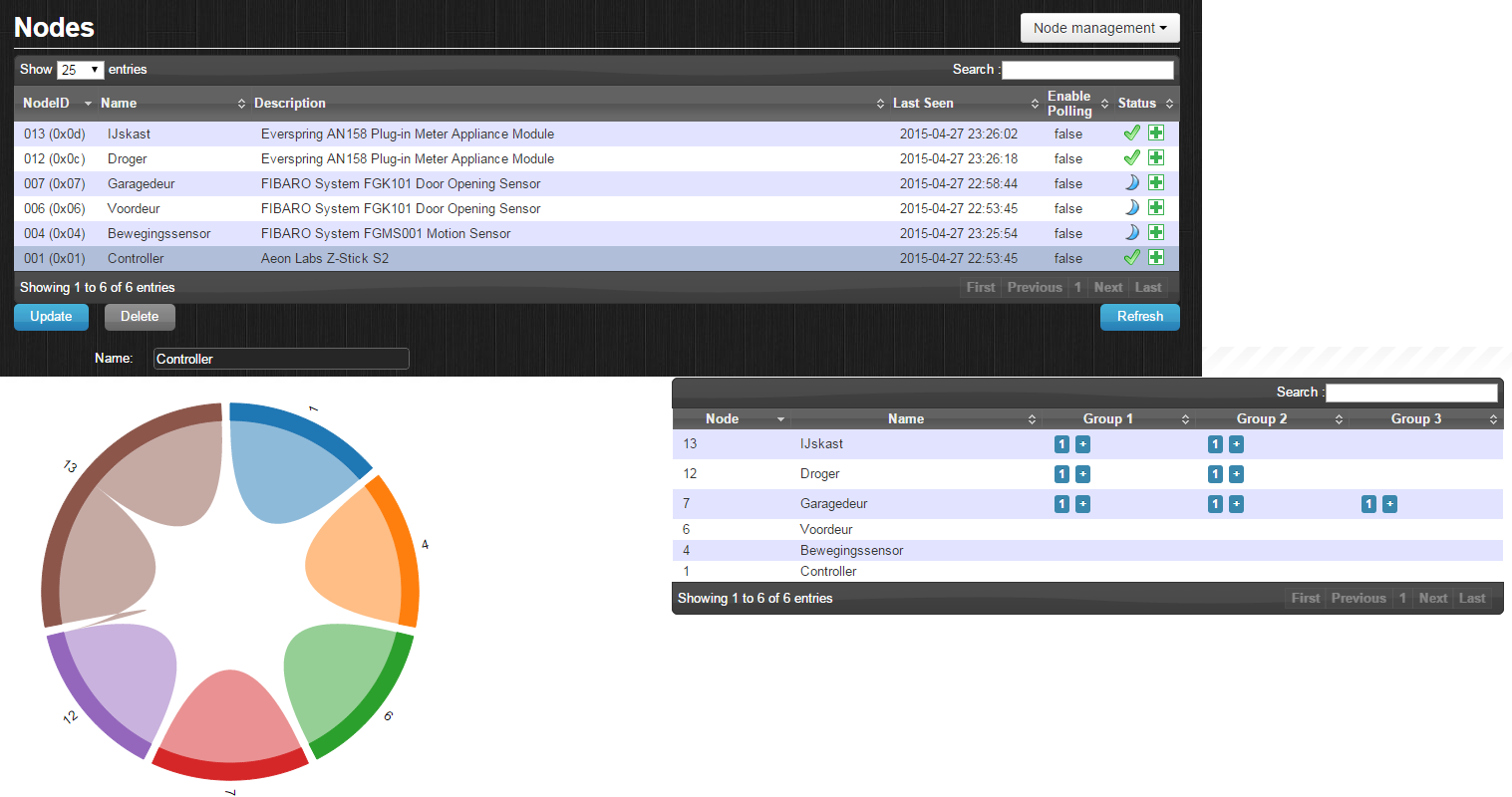

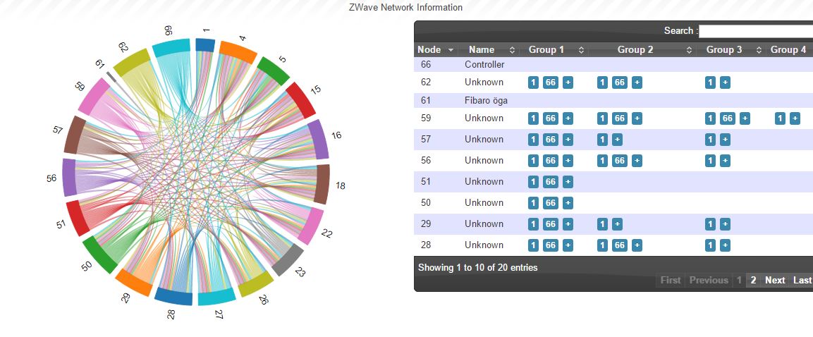

I am just starting with Z-Wave, but I think my Group is not working allright because none of the nodes is connected to the controller in the picture.
See screenshot below for the nodes I'm using and the network information.
The nodes are working, but any suggestions if I need to make any changes to the groups?

I had this issue and i gave the controller a hard reset and included all nodes again (you will need to do that as a hard reset clears it all)
But you could also have a range issue.

tlpeter wrote:I had this issue and i gave the controller a hard reset and included all nodes again (you will need to do that as a hard reset clears it all)
I will give that a try. I don't think it is a range issue, because the frontdoor sensor is within 2 meters of the controller.

I gave the controller a hard reset and included the nodes again and now all is working allright.

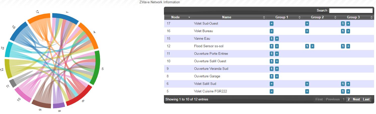

Do you know the meaning of the line width in the zwave network graph? I remarked that most of the newer devices have thin lines at their ends while older devices have all bold lines. I mean by "newer" that they are a few days old and have already communicated successfully in the network of course.

I always though the thinner lines were battery operated devices so they don't repeat signals. Whether that is correct or not i don't know.

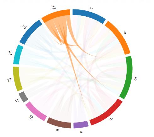

Hi Stuviow,
No, it is not the case in my network :
As you can see, the door sensors (9,10,11) have bold lines and operates on battery, and are sleeping devices.
The two last devices I added are roller shutters (16 & 17) and display thin lines (the "Bureau" one has been installed more than two weeks ago and still display thin lines at their ends) :
I would like to understand the meaning of those thin lines !
Domoticz on RPi2 - RFXCOM RFXtrx433E - Weather Station WMR200 - Z-WAVE.ME UZB - Fibaro FGR[M]222, FGFS101 - GR105n - Opus XT300 - téléinfo Elec.- Everspring SM103 & Vision ZD2102 - NAS Thecus N4800 - Logitech Harmony Ultimate - MXIII-G + Kodi :D

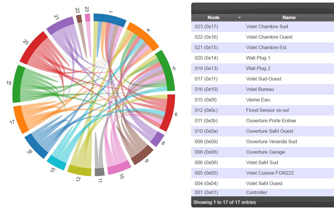

No answer on my previous question? Well, I have another one: why does it show two devices without interconnexions though they work perfectly fine in my network ? :roll: :) Devices 21, 22 & 23 have been included in one hour time-frame. 21 showed interconnexions immediately, nothing for 22 & 23 that are exacly the same.

Well, healing the network seemed to reorganize its view:
