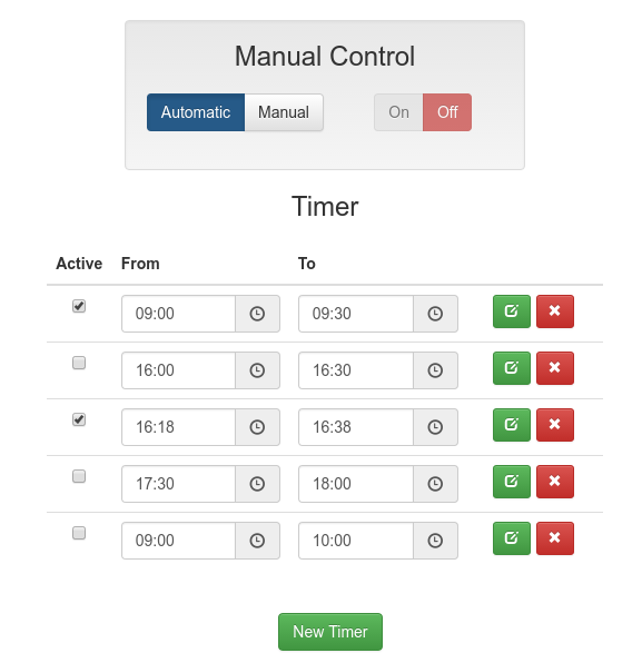

valdis
- Posts: 5
- Joined: Sunday 18 September 2016 10:39
Re: Time switch feature
more like this (see attachment)
- 2016-09-20_17-50-57.png (38.24 KiB) Viewed 4530 times
oliviers
- Posts: 74
- Joined: Wednesday 16 September 2015 22:10
- Domoticz version: Stable
- Location: Paris area, France
Well,
1. Go into "settings", and check "custom" in "Active Menus"
2. Store your web page in /home/pi/domoticz/www/template and modify index.html to point to it
3. Assign the right script ot http command to each of your buttons
Your Web page will be accessible via the "Custom" tab in Domoticz.
Does this do the job ?
Oliviers
Oliviers
