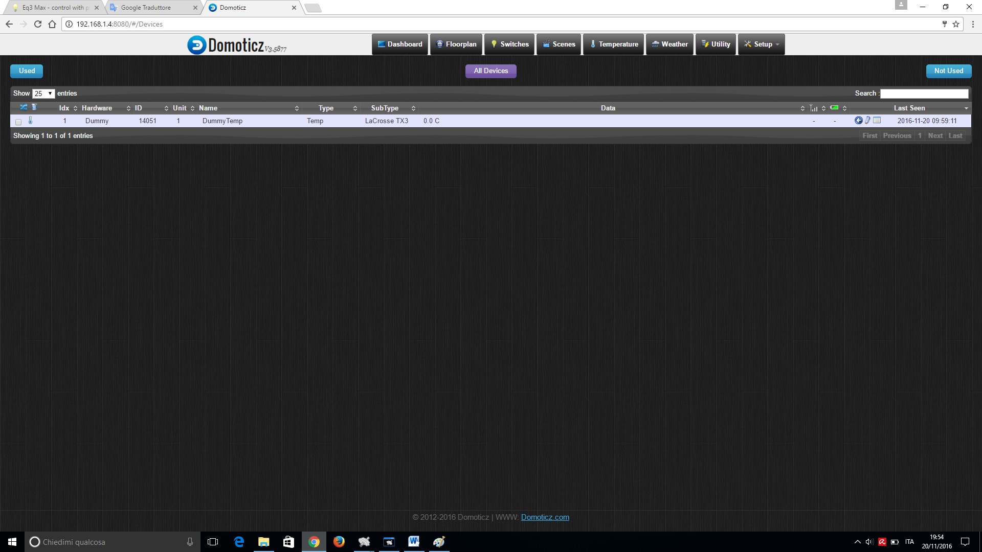

jack74
- Posts: 9
- Joined: Wednesday 16 November 2016 12:27
Re: Eq3 Max - control with php scripts
Hi TikTicz,
thanks a lot for your quickly answer...
I attached my configuration and I think that it should be correct.
Can you indicate me where I should find the files generated by the script? Is it possible that I have some permission limits?
Jack
Jack

TikTicz
- Posts: 14
- Joined: Friday 16 September 2016 20:35
The syntax seems ok. Did you try "http://192.168.1.4:8080" in your browser and did it show the Domoticz dashboard?
I am not aware of any permission limits.
The script does not generate files. It creates devices in Domoticz. You can check this by selecting tabmenu "Setup" in domoticz and in the dropdownlist choose "Devices" and in one of the pages you should see something like on the screen print I included. Also in tabmenu "Setup", option "Hardware" you should find "Eq3Virtual".
jack74
- Posts: 9
Yes, I tried and it works...

jack74
- Posts: 9
I attached two screnshots...
I hope that you can understand why the script doesn't work...
Thanks a lot for your support...
- dev.jpg (366.51 KiB) Viewed 19897 times
- hw.jpg (388.16 KiB) Viewed 19897 times
TikTicz
- Posts: 14
Attached a new version of the script files. As they contain some minor (not related) improvements replace your script files with the new ones. Also find an additional script domocreatenewhardwx.php
This is the same code as domocreatenewhardw.php but with some additional print instructions for debugging. Run domocreatenewhardwx.php and see if the result makes sense to you. If not upload the result of this script and I will take a look.
