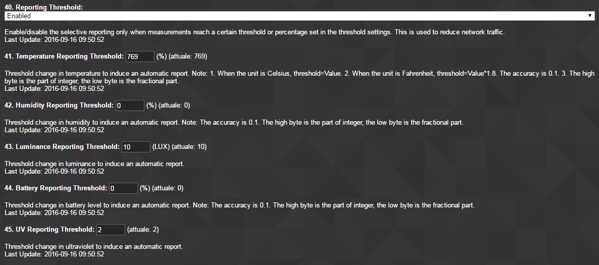

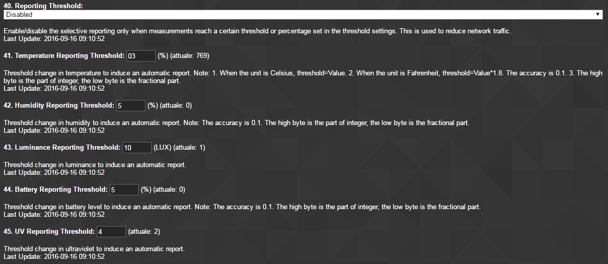

i want to set the report for temperature and humidity only in case of Threshold change, as described in the manual (screenshot.322.png).
So, i set in Domoticz these data (screenshot.324.png).
But the result is very bad (screenshot.325.png).
Seems that domoticz ignore my data changing as he wants.
Have you any idea?

No, it doesn't work.
If I insert value 3 (in order to set the threshold at 0.3C) the multisensor convert it to 769.
If I insert 769 (only to try the opposite) the multisensor convert it to 257.
Also the parameter 201 (Temperature Calibration) is fixed to 1. All values inserted, return 1.
I also open a request on the Aeotec support page.
