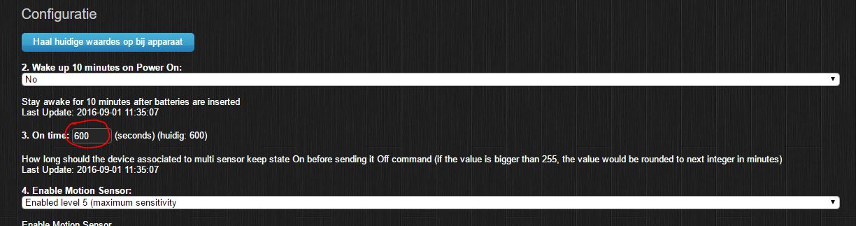

Correct, so how do you suggest I'd set it up. So I want my light to turn on when the light in the room is under an x-amount of Lux (MotionSensor6), but only when motion is detected in the living room. If there hasnt been any motion for >15 minutes the lights need to be turned off.
If you have a multisensor you can set the time in the settings menu of the sensor.
