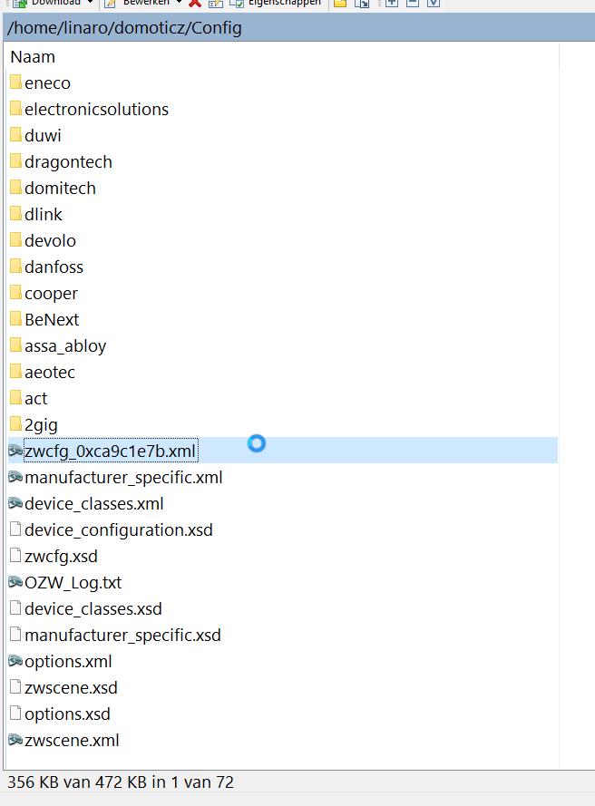

Xheck your Zwcfg,xxxml file in the config map. [ winscp ]
Is this from you as user?
Or is this root?
Check all your batterys of your battery devices!!!!! [ not in Domoticz, with a battery tester ]
Or wakeup them!
En the reboot your pi. or ....
En place some log files

Derik wrote:Xheck your Zwcfg,xxxml file in the config map. [ winscp ]
Or is this root?
Or wakeup them!
My zwcfg.xsd is like this:

Derik
Posts: 1605
Re: Not all Nodes have been Queried yet, OpenZWave not fully initialized yet!
Post by Derik »
some battery devices can kill your network when they are all most empty.
You also can try to stop domoticz
Remove the Zwcfg.xxx file and reboot..
and then check or the Zwcfg file is from u as user.
edit:
This is my file:
<?xml version="1.0" encoding="utf-8" ?>
<Driver xmlns="http://code.google.com/p/open-zwave/" version="3" home_id="0xca9c1e7b" node_id="1" api_capabilities="0" controller_capabilities="8" poll_interval="50000" poll_interval_between="false">

So i think you got the wrong
Evelen
Posts: 234
Joined: Thursday 09 July 2015 12:03
Domoticz version: 2.4538
Location: Norway
Post by Evelen »
oh.
I did took the file from "open-zwave-read-only/config"
my file from "domoticz/config" was "zwcfg_0xd3cf129c.xml": (tryed to delete this)

It is also a file called "zwcfg_0xf3eab290.xml" from root (don't jave access to read og replace this)
Derik
Posts: 1605
Post by Derik »
try to delete them
Stp first domoticz
Then delete
Then update/upgrade
reboot
check if files are user and not root..
Evelen
Posts: 234
Location: Norway
Post by Evelen »
i found and downloaded zwcfg_0xd3cf129c.xml from hardawre tab in Z-wave @ domoticz (download config):
also, rebooted server (vm), then stoped domotics.sh service
now I deleted the file (renamed) and I head access to do it.
started service, domoticz.sh.
now it worked :mrgreen:
