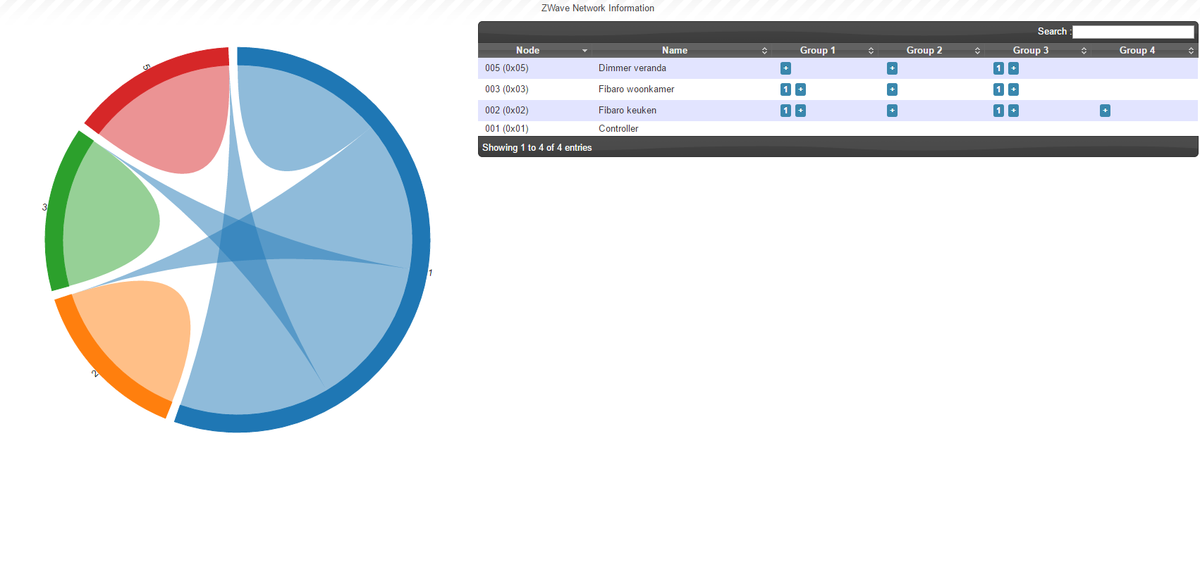

I have included the node, it seemed it was to for from the controller. But now I have moved the dimmer back to its intended location it can't be reached. Logging says: 2016-08-20 12:11:45.554 Error: OpenZWave: Node has failed (or is not alive), Switch command not sent! (NodeID: 5, 0x05)
Network looks like this:
What can I do to fix this ?

Try "Heal network" (the button above Groups & Network)
