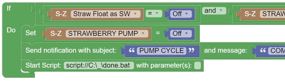

Oxyandy
Joined: Thursday 22 February 2018 8:47
Run local batch file Windows
Post by Oxyandy »
Hi I have Windows 10
have tried a bunch of different syntax - log says
2018-02-22 18:37:13.940 Executing script: 'C:\_\done.bat '#
But it never fires the batch file
help please
New Bitmap Imtttage (2).jpg (74.18 KiB) Viewed 12601 times
