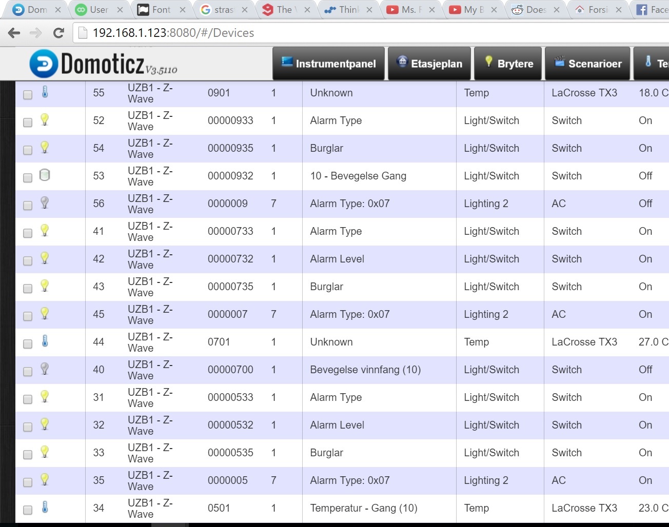

hmm, looks like the values is difrent, how do i know witch number to look at?
Uten navn.jpg (284.74 KiB) Viewed 1928 times
Egregius
Posts: 2592
Domoticz version: v2024.7
Location: Beitem, BE
Re: See which node a device belongs to?
Post by Egregius »
The NodeID in HEX (between brackets) is mostly in the ID of the device:
Example: Node 40 (28 in HEX)
And of course: name each device, even if you don't know what it does. It'l make life much easier later.
