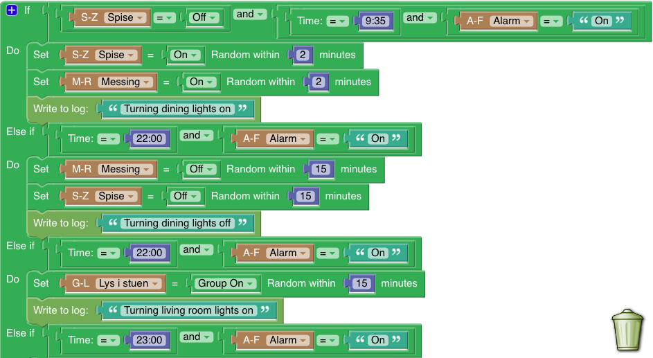

Hi there.
I tried creating a blockly script to make my lights turn on if the alarm is in the on state. My alarm is a simple threeway switch ("On", "Off", "Home on"), as I have not found a way to change the "armed" state of my home using a switch.
My current blockly looks like this. None of the events are ever triggered.

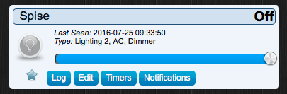

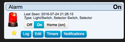

My devices look like this

Can anyone suggest how to fix the problem or suggest a Lua script alternative?

the first line states ".... and Alarm = "On" "
A selector has numeric values, i.e. 0 for Off, 10 for Level1, etc. So I think your blockly needs to check not if it is "On" but if it is "10". And I expect it not to be text (that is not between quotes) but as a number.
I should test it before I post something here. :oops:
It works with the text blockly, so I need to investigate it some more.
Did you choose the blockly to be "Device" or "Time"? When I test it as Device, it doesn't work, but as Time it will.

Thanks. I had my script set to "Both". I tried modifying it to time but it still did not work.
I got it working by adding an extra and testing if a light was off or on in each of the statements.

If Alarm is a multi selector, you need to set it as 0, 10 or 20.
You can also look at my blockly:
http://domoticz.com/forum/viewtopic.php ... 043#p71013
