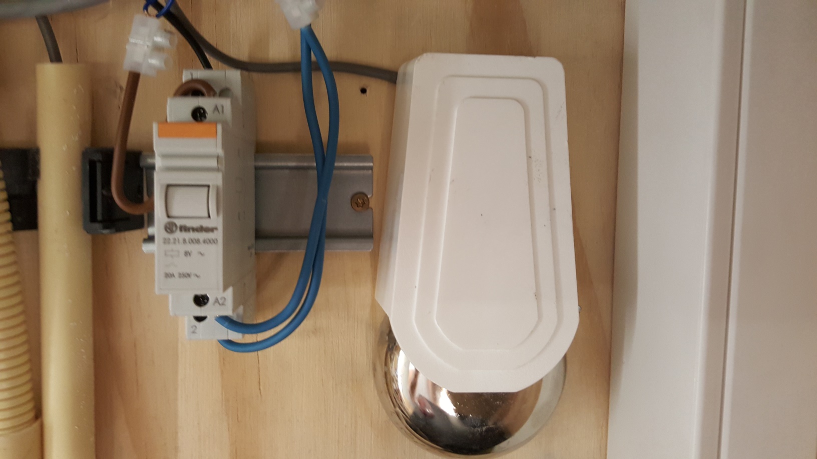

sincze
Posts: 1302
Domoticz version: 2024.4
Re: connect my normal "non-smart" doorbell to domoticz?
Post by sincze »
Haha damn.
Great idea the Arduino solution.
I already had the ACDB7000 so I used the relais solution running separate from my existing doorbell.
Great descriptions on how to do this can be found here:
http://eye-vision.homeip.net/5994/draad ... ment-67455
And here:
http://www.nodo-domotica.nl/forum/viewt ... =12&t=1572
Wiring things up
Components needed: RELAIS for the appropriate voltage:
This is how Henri did his wiring:
So I ended op like this:
