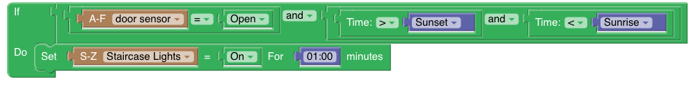

need help
blocky script not working

There is a logic error: Time can never be bigger than SunSet AND at the same time smaller than SunRise! This is impossible.

Re: blocky script not working
So it should be "or" instead of "and"
making
door sensor = open and (Time > Sunset or Time < Sunrise)
Try to make you're blocky script like this :
If time is > then sunset and doorsensor = open
Set staircase lights = on for 1 minute
Else if
If time is > then sunrise and doorsensor = open
Set staircase lights = off
That only make more code... and it will not work in the morning :-/
changing and to or is enough...
Just use:
if door sensor = open and (Time > Sunset or Time < Sunrise)
do set etc...
So you can enjoy your light for a minute when the sun is down and the door opens!
