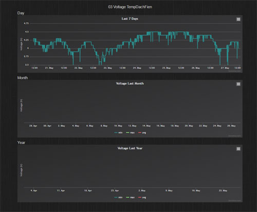

Doing that, I can have a look at the voltages under "Utility" and clicking "log" I get charts for "days, month, year"
Now, since a few versions ago (can't tell exactly, sorry) there are no values displayed in the "month" & "year" charts.
Any idea anyone why this should be so?
Apart from regular Domoticz updates there were no changes lately, especially in the sensor firmware.
Thanks,
Christoph

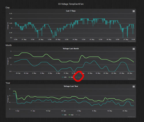

EDIT:
Gets weirder. It's got to do with the otherwise really fancy "min/max/avg" buttons. When I select "min" and "max" ONLY there is a display
again. Adding "avg" the chart is empty:

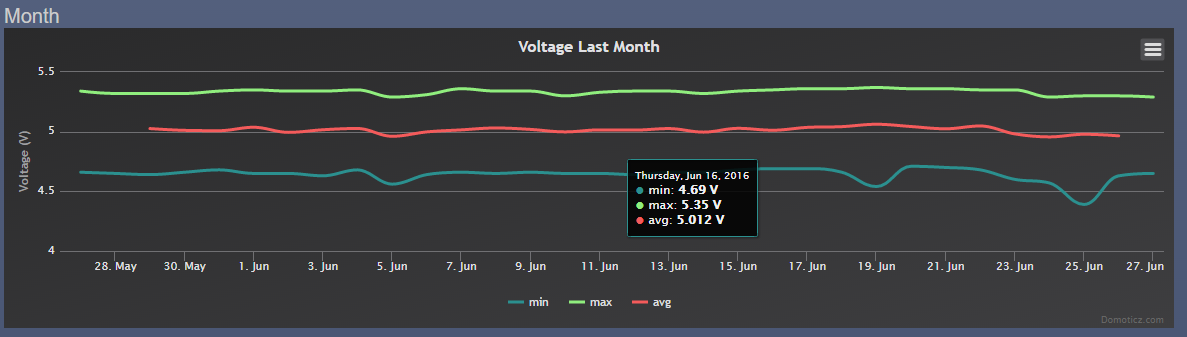

Dont experience this issue here:
