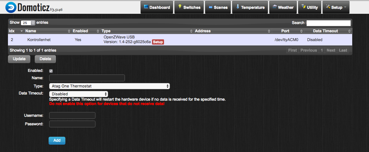

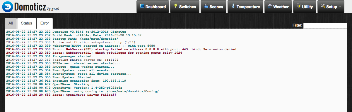

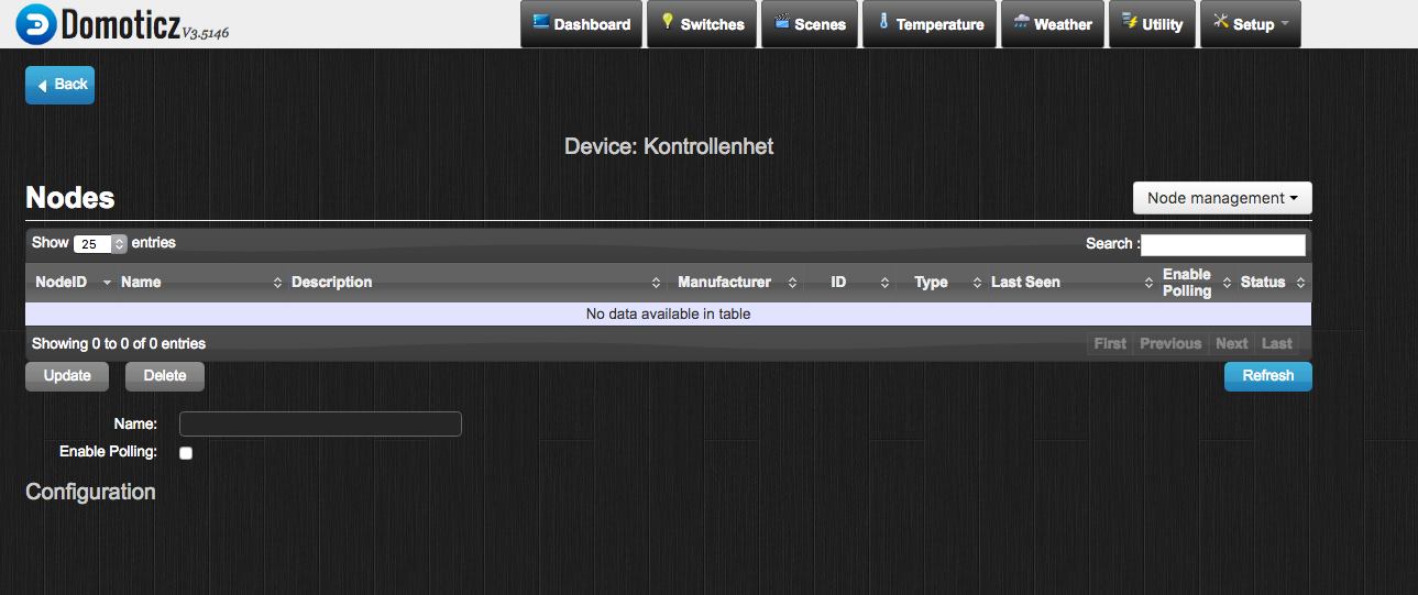

Re: Aeotec Z-Stick problem
Ok, i have tried that but it didn't work.
I re-insalled debian from scratch and then OZW and Domoticz.
But as soon as start Domoticz i get Driver Failed.
See pictures.
Anybody that have seen the same problem on Debian?
See pictures.

ok read carefully everything and now check your 2nd screenshot your Zwave is set on port /dev/ttyACM0 which is wrong from my experiences.
when i did the reinstall i did it like i did fo rmy zwave.me GPIO card ... i was wrong the corect way is in the Wiki page i sent you and like this it will work. no more driver error after i followed the wiki page.
Hope it will help you.
