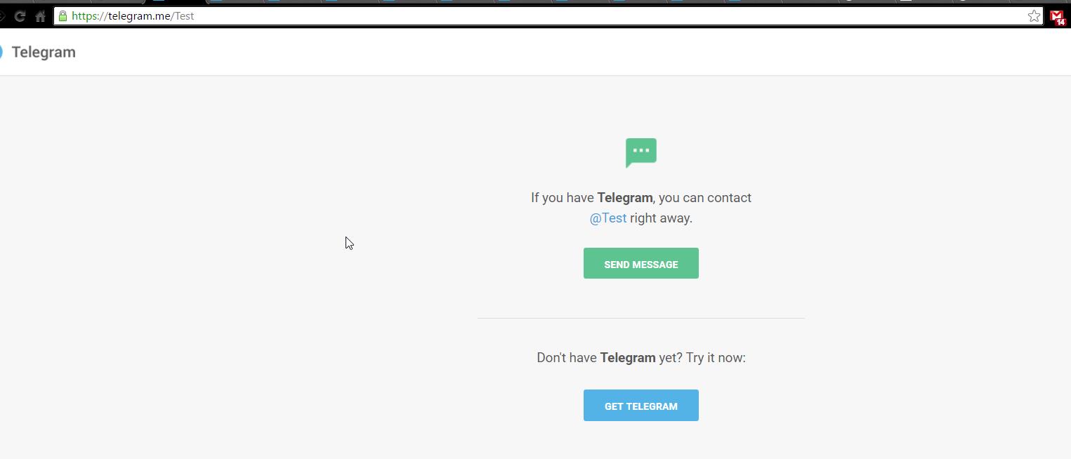

Dear Dominikat,
I try your "wiki"...
Only i have in my browser a new Bot. [ Test ]
See the bot:
I cannot get/set a username ..
And i cannot find the bot in my windowsphone... app
Please some prints..
