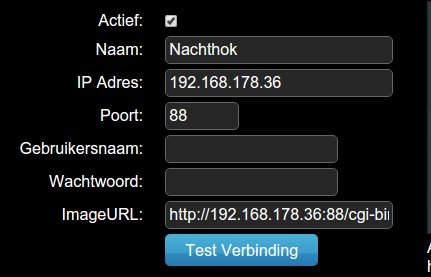

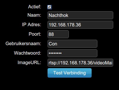

Almost distraught. I have the camera FI9816P and get this not working.
With the Firefox browser, it's all good but succeeds through Domoticz
not. I followed the wiki, many URLs tried but to no avail.
Who knows advice? This is what I have.

rtsp is not the image url, but for live video

The screenshot was just an example. I have many URLs
tried. What is the correct one.

Try leaving the user name and password field empty, and set the credentials in the URL.

I tried that and even though the other suggestions but no luck.
With Firefox direct i have it working.
Maybe it's my configuration, Domoticz on the RPI.
For example (at the URL below)
http://192.168.178.36:88/cgi-bin/CGIStream.cgi?cmd=GetMJStream&usr=test&pwd=test

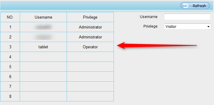

cobra045
Posts: 46
Joined: Friday 12 February 2016 20:58
Domoticz version: 3.4834
Re: Problems with the Foscam 9816P.
Post by cobra045 »
No, for domoticz I just created an operator
