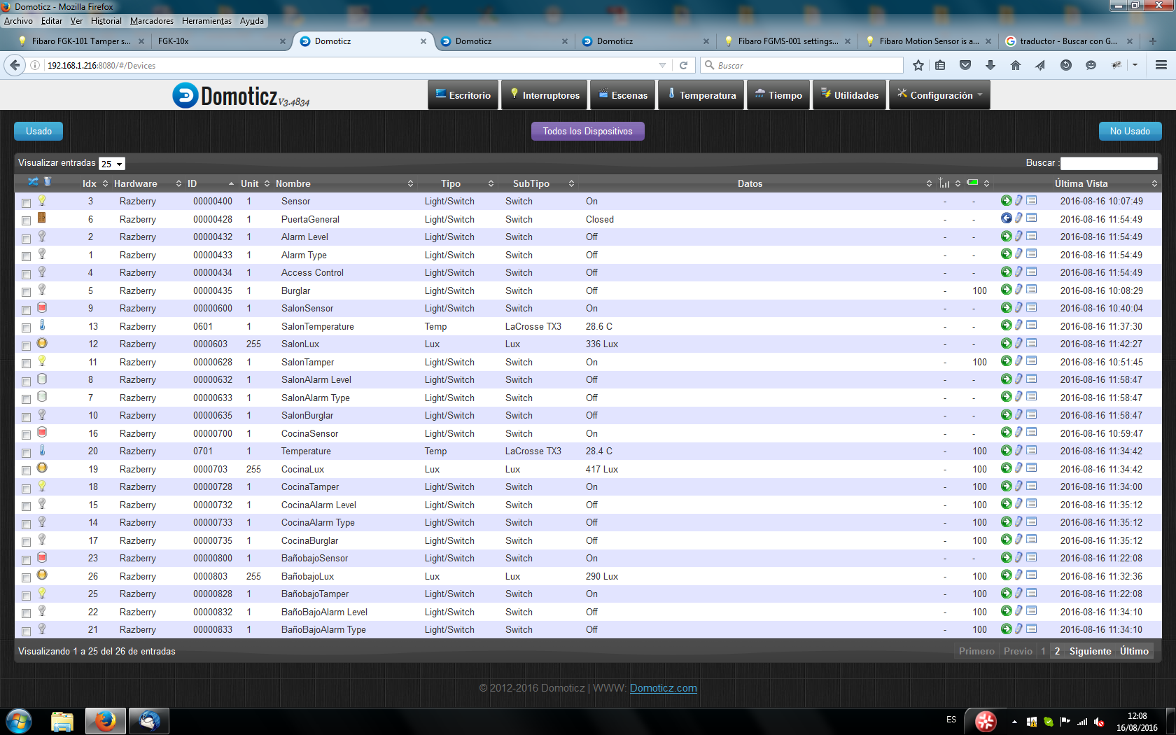

Hello everybody.
I have a new problem with fgms-001 fibaro motion sensor.
I install a new raspberry + razberry. When I include a FGMS-001 (3 units) then it show the next image.
The ID 600-700-800 are the FGMS.
I don't know why the fgms are always on.
