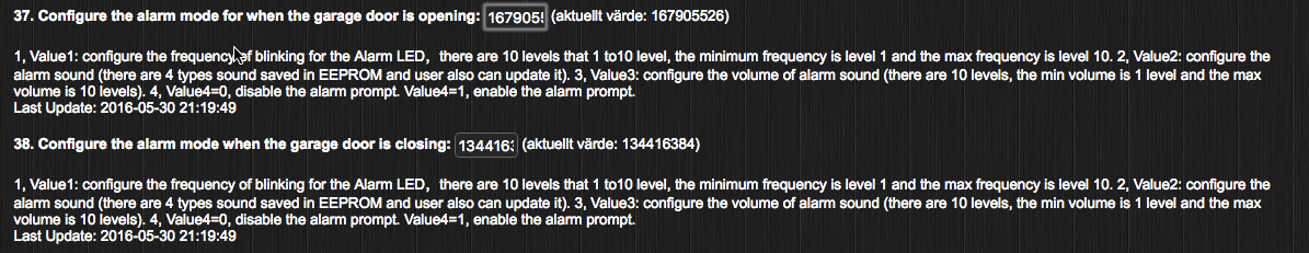

I have just installed an Aeon Garage Door Controller.
Anybody that knows how to turn the sound off?
it wakes up the whole neighbourhood. :)
I can't manage to do it.
In the configuration options it is an explanation how to do but from the code shown i can't figure out how to do it.
The default code doesn't say anything to me when I compare it with the values to set.

change the vallues to 0 in the openzwave config.
