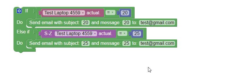

And this blockley is not working...[ both counters not ]
Where do i wrong?

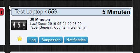

is pi the owner of the script?
or root?
local timer_device_ID = 4559
if otherdevices['IP: Mie'] == 'On' then
  local TotalMinutesOn = otherdevices_svalues['Test Laptop 4559']
  TotalMinutesOn = TotalMinutesOn + 1
  commandArray['UpdateDevice'] = timer_device_ID .. '|0|' .. tostring(TotalMinutesOn)
return commandArray
Do you have the names of your devices Correct???

some one has a b;ockley wprking with this counter...
Set x after y minutes / day...

Derik wrote:some one has a b;ockley wprking with this counter...
Haven't tried this yet, when I have time I will give it a go. I remember that there were more device/sensor types in the past that couldn't be read properly from Blockly. I had problems myself with a dB meter in my Netatmo weather station. So we could just be unlucky ...
By the way, you can also send notifications from LUA directly, I'm pretty sure that will work anyway.
