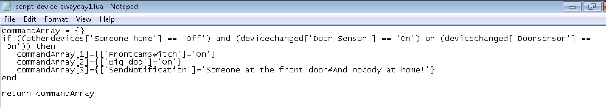

Post by markk »
I had an event in blockly to run if no one was home and the front or back door sensor was triggered but, because my door sensors are always "on" and you can't (as far as I'm aware) define "other devices" or "device changed" in blockly, it run true every time the last person left the house and the "someone home" switch turned off.
So, I tried to do the same thing with lua using the script below but it runs true even if "someone home" is "on". I can't see what I have done wrong.

Post by mrf68 »
Remove first ( and place it in front of the other ( after 'and' .

Post by markk »
@mrf68 thanks for that. much appreciated. you wouldn't believe how long that has had me stumped.
