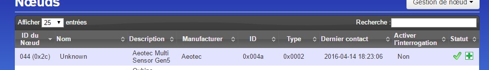

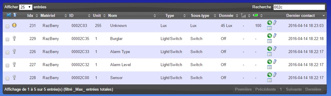

Afert insert my new multi sensor AOTEC GEN5 with "Include Node" (I try Include Node Secure too), only 5 devices appear in domoticz. Temp and Hum are absent. But all object are in Z-wave Control Panel.
Any idea ? Help is highly apreciated !
Log in domoticz durig the attachment :

Post-resolved : the device is registred as
242 RazBerry 2E01 0 TMP HUM Allée Temp + Humidity WTGR800 26.0 C, 24 %
"0000" miss before the id number
Thks
