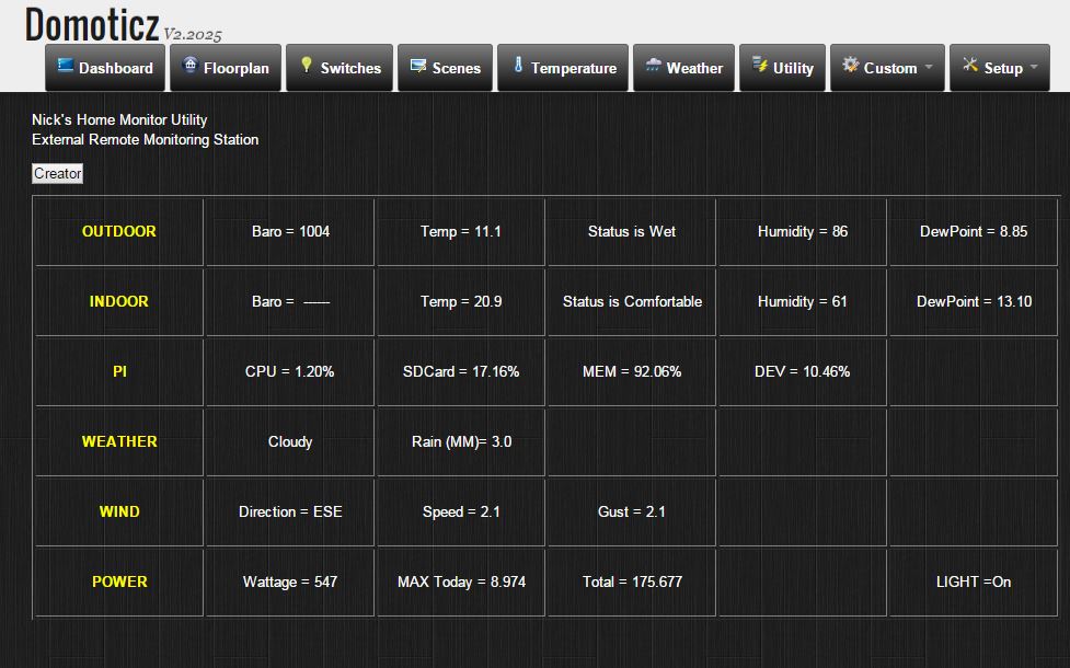

Anyone give me an idea how to put this in the dropdown list on the room plan.
I have SD Card Usage, Memory, CPU , Boot & Root but no Temperature.
Am I missing something ?
Or just that it doesn't come up.
I need it for my new easy read screen
Raspberry PI CPU Temp not showing in roomplan

Thanks, that info was great and fitted in perfectly into what I wanted.
Now for some more graphical changes and Iphone Size Mods and I am away.
Appreciated for the quick reply mate, always depend on people to help.

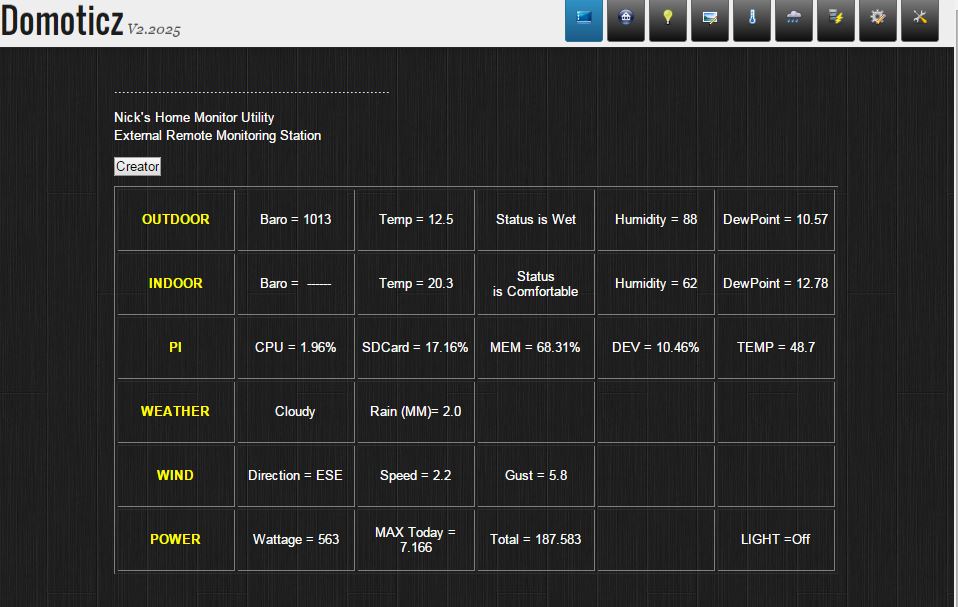

I have rebuild the hardware monitoring device, and in the next beta it will show up.
Also now you can add notifications, and send it to master devices etc.
but you will get all new devices for the motherboard hardware
This was needed because this class put the values directly in the database and did not use the normal way....

Cheers for the reply Gizmocuz, how I did it was edit the Page.Array section and just put roomplan page to 0, everything shows up then. On roomplan 3 (what I was using) it wouldn't show. Still, if it's added in an update, no-one else will have the same problem. Keep up the good work as this is a brilliant piece of software.
I just find it very hard to create a decent custom page because of the </div> commands and cannot find the way to transfer the JSON readings into the HTML, for come reason they all come up blank. A bit of a novice at the present.
Thanx again.
Nick
