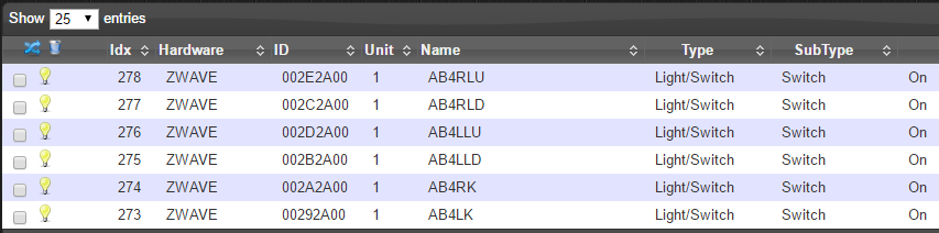

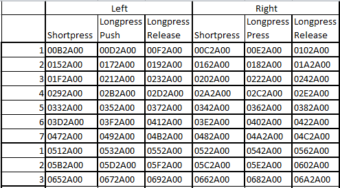

I've done it another way:
I did change 2 of the Groups switches to act as "Send Scene" and act upon the associated switch in Domoticz. The below only works for "Send Scene" switches.
Example:
Jos
ps: Maybe adding the controller to the group already fixes your issue but I haven't tried that.
Example:
- Changed 13 to "Send Scene".
- Ensure the zwave controller is added to the Group for the associated switch. In my case I added 1 to group 5 of the remote control device. (picture 1)
- Enable "Accept new Hardware Devices"
- Press the buttons both short and long, which will created 6 switches (See below table picture 2 for potential ID's created)
- Go to the Devices tab and activate the Zwave IDs for the switches created. In my case for Buttons 4: (Picture 3)
....IDs =>Left:0292A00/02B2A00/02D2A00 Right:02A2A00/02C2A00/02E2A00
Switch=>Left:AB4LK/AB4LLD/AB4LLU Right: AB4LK/AB4LLD/AB4LLU - Create a script to act on any of these switches AB4????.
Jos

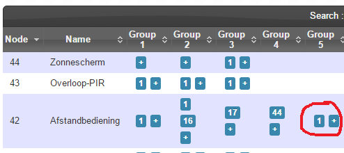

Hi Jos,
Your last PS did the trick. I noticed that for the scenes, the controller was added but not for the group. Added it and now domoticz sees the key presses.
H
H

Hello Jos,
It would be GREAT if i could switch on a "per device" basis, but I THINK it is only possible to switch groups and scenes.
If I could switch groups it already would be a very good start. I don't need to do a lot of different things, just to keep the wife happy
As per the threat i found the "Groups and Network" portion.
There I go to the "+" on "group 2" of my remote (group 1 is the "lifeline" and 2 is the first button) and then I add the node-number of the Fibaro switch i would like to switch. It is node-number "010 (0x0a)" from my node-list.
But it "just does not "stick".
I tried "waking up" the remote before, during and after i made the change. tried a gazillion reboots of the Raspberry, tried to "wait it out".I also tried add the node-number as 10, 010, 0x0a, all with the same and consisten result......... nada.
I actually started using different browsers because by now i really don't know anymore.
As stated, all i can find is that this "thing" is capable of switching groups and scenes (again, i would be happy if it did) but that contradicts a bit with adding "nodes" in the "Groups and Network" menu.
ALSO, when i try to change the default behaviour of a button from the default "switch on/off and dim" to "switch on/off only" it just does not stick.
I tried this in the Domoticz properties screen, but also in "node management / control panel". Just nothing sticks.
What i ALSO tried was going to a "group" (in the scenes tab) then "edit" a group and try to add an "activation device". just getting "timeout" there.
