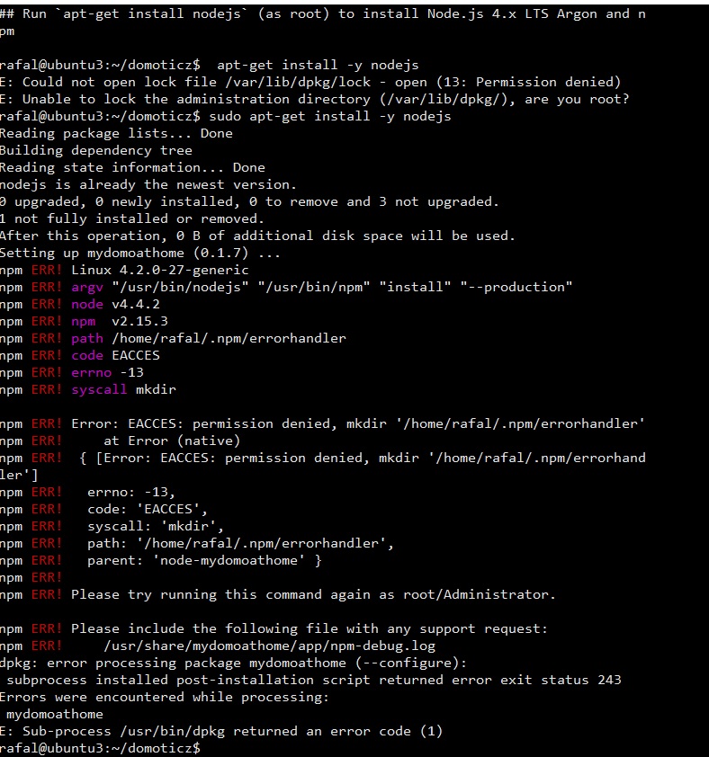

rafal
Posts: 22
Joined: Sunday 13 March 2016 12:45
Domoticz version: latest
Re: [MyDomoAtHome] Support thread
Post by rafal »
Hello :)
You previous (old) verison on MyDomoAtHome was working excellent on ubuntu serwer 14 LTS with Domoticz.
On second machine i'll try install gateway for Domoticz with noodejs Install procedure on github.
What i doing wrong???
Thank You

rafal
Posts: 22
Post by rafal »
Thank You for answer :)
Stuck on a pre 0.1.x version
apt-get remove mydomoathome
apt-get update
apt-get install MyDomoAtHome
done !
but still the the same :/ waiting for update :)
PS Thank You epierre for You hard work !
Doler
Posts: 163
Joined: Friday 31 July 2015 21:02
Location: Sint-Oedenrode, Netherlands
Post by Doler »
rafal wrote:Thank You for answer :)
apt-get update
done !
You should put 'sudo' before the commands.
