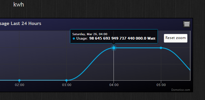

Hmm don't know what happened (various reboots of Domotiz/NAS probably), but the counter is back! So that's the good news. Too bad; I have my original problem back, see this picture:
There is an extermely high counter value. The others seem zero, but are actually more in the rang of 8kWh, 10kWh, etc., so that seems appropriate. Any idea what might cause this? Should I add something in my Nodo Small script not to upload a counter if it is in the range of Megawatts? Or isn't this caused there?
Regards,
Marco

So as far as I can tell pretty good. Max is 220 (dec.) Note my meter runs 187 turns in a kWh.
Anyone know why I get the enormous counts as seen in the picture of my previous post above? Would the zero counter be a problem?
Regards,
Marco
