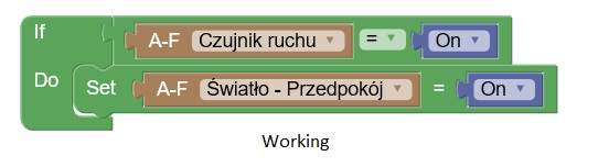

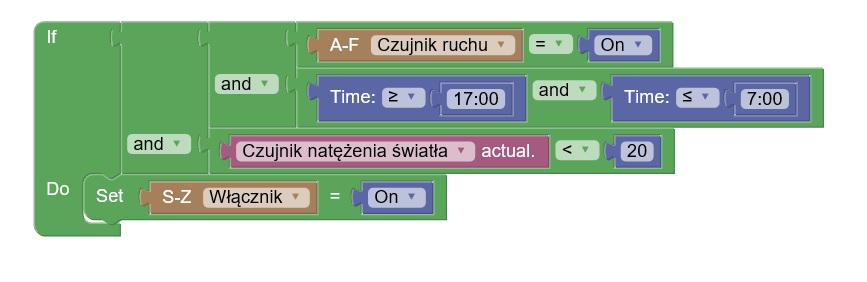

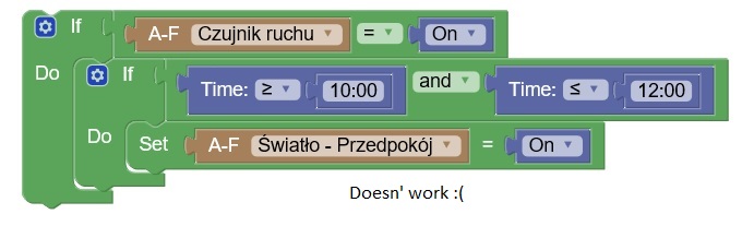

I'm trying to make some events in Domoticz but with no success:(
In attachment I put two examples of event that switch light on when motion is on.
One works but when I add time event it doesn't and I don't know why?

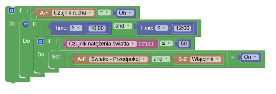

I also try to switch on my two lights named (włącznik and światło_przedpokój)when my motion sensor is on - between 10 and 12 o'clock and when may LUX sensor from Fibaro motion sensor is lover than - 50.

From 3 examples i wrote, one is working well. There also is motion sensor = ON and script is working. I was thinking there is problem in other place of this script but I don't know where.

How did you put nested If in Blockly?
I was not able, don't know if this a browser issue (Chrome).
In any case, I suggest to go with Lua script, more indicated for "complicated" script...

I don't use chrome. In chrome I had problems with all scripts (nothing worked). I'm using IE.
I solved my problem...I send photo of my new script (now everything works great)
