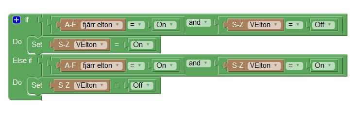

i have also tried to do the script as blocky, but when i do, the virtual switch (VElton) is going on/off every second.
Fjärr Elton is renamed to "Felton" so its not wrong :)
Whats next? What can i do with the toggle options in Lua scripts?
Thanks for your help!

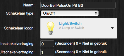

Then I make virtual switch type On/Off and set Delay-Off to 1 second :
Schermafbeelding 2016-03-16 om 20.40.30.png (59.69 KiB) Viewed 8954 times

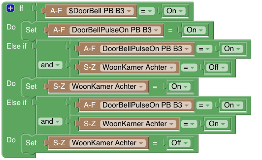

Then I use a blocky like this (Woonkamer Achter is a Living-Lamp) :
Schermafbeelding 2016-03-16 om 20.40.59.png (71.35 KiB) Viewed 8954 times

when it just sends a ON command, you could link the switch to a scene that switches on'DoorbellPulseON PB B3' (or use your own virtual On/Off switch with 1sec delay off).
Then you have a 1sec pulse on every ON command that you can use with the above blocky (don't use the first If statement)

I have finally solved it, on the remote settings i choosed (Off Delay) 1 second. Then the remote will go OFF instead of going ON all the time.
After that i used blocky the turn the virtual switch on and off.

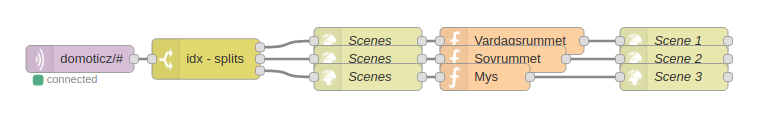

Has anyone Node-Red and MQTT on their Domoticz server?
It helped me a lot! - Instead of fiddling around with LUA scripts or Blocky with additional virtual switches.
Here's another way to solve toggling of (in this case) scenes with a one button remote:
Screenshot from 2017-02-04 23-35-34.png (19.12 KiB) Viewed 7930 times
The button that you create in Domoticz should be an "on button" & Domoticz sending out status messages on MQTT
It should be totally independent of any other way of toggling your scenes, so your normal ways will also work with your old scenes.
