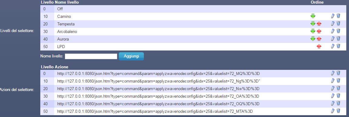

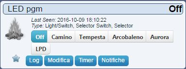

I found a way (well.. really HE clarify the way!!
you have to specify the value in an encoded way
once you had all your links create a selector switch and add the commands
mine looks like this
Note1
the IDX link is the ZWave Device Hardware not the Selector Switch, nor the RGB Switch
Note2
the OFF signal on selector does not power it off, it just stop the program leaving the current color
you have to issue the OFF switchcmd using the RGB Switch
hope this would help!
I'm now looking a way to force the color using JSON
Note1
Note2

It is working fine. I added it to my system last night.
Go to the hardware tab, press F12 (chrome) and select the network tab. Click on "Setup" for z-wave so you see all the devices. Then if you click on the request in the developer panel (Poll... something if I remember correctly) you have a tab to the right called "Preview", find the node for the RGBW device in the response, expand it and there you have your idx.
Then create a virtual selector switch with the values mentioned above and you should be up and running.

Enable developer in Chrome (F12 key).
Go to openzwave
Locate your RGBW device
Select a program to run (i popped in 9 in Option 72).
When you then click apply configuration to device, you will find lines of code appear, one will be a long link.
Look for the IDX code, thats what your after (in my case, its IDX41) (see circled)
