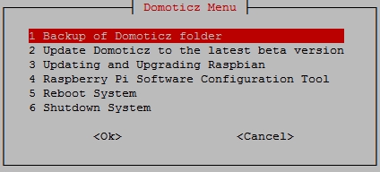

This is what I've made so far... These are my most used functions if I use ssh.
Naamloos 2.jpg (44.2 KiB) Viewed 3809 times
#!/bin/bash
clear
RETVAL=$(whiptail --title "Domoticz Menu" --menu "" 12 53 0 \
"1" "Backup of Domoticz folder" \
"2" "Update Domoticz to the latest beta version" \
"3" "Updating and Upgrading Raspbian" \
"4" "Raspberry Pi Software Configuration Tool" \
"5" "Reboot System" \
"6" "Shutdown System" \
3>&1 1>&2 2>&3)
# Below you can enter the corresponding commands
# Create backupz folder in pi folder first
case $RETVAL in
1) echo "Backing up Domoticz folder... (please standby...)"
sudo service domoticz.sh stop
sudo tar --verbose --verify --create --file=./backupz/domoticz_bak.tar domoticz/ --exclude=domoticz_linux_armv7l.tgz
echo "Restarting Domoticz... (please standby...)"
sudo service domoticz.sh restart ;;
2) cd ~/domoticz
echo "Updating to latest beta version... (please standby...)"
sudo cp domoticz.db ../backupz/domoticz.db
mv domoticz_linux_armv7l.tgz ../backupz/domoticz_linux_armv7l.tgz
wget http://releases.domoticz.com/releases/b ... armv7l.tgz
tar xvfz domoticz_linux_armv7l.tgz
3) sudo apt-get update
sudo apt-get upgrade ;;
4) sudo raspi-config ;;
5) sudo reboot ;;
6) sudo poweroff ;;
*) echo "You chose Cancel." ;;
esac

this is the simple script now (with tips from above):
todo:
- Setup wifi
- split software into a sub menu so we can add more on a different menu
- help with cronjobs
- every nice and handy tutorial from the wiki can be added (with choices/variables/info and input boxes etc)
please shoot!
#!/bin/bash
##whiptail —yesno "Did you already know whiptail?" —yes-button "Yes, I did" —no-button "No, never heard of it"  10 70
##  CHOICEs=$?
clear
"5" "Install Extra software" \
"6" "Domoticz configurations" \
"7" "Fix permissions" \
"8" "Reboot System" \
"9" "Shutdown System" \
3>&1 1>&2 2>&3)
