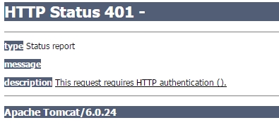

No i did read that could be the problem.
on https....
I got this back
on https....
I got this back
- 2016-01-22 15_23_06-Apache Tomcat_6.0.24 - Error report.jpg (35.51 KiB) Viewed 6139 times
Yobby
- Posts: 12
- Joined: Thursday 10 April 2014 9:18
Re: SolarEdge in Latest Beta / Port Number
Sorry, my bad.
Change the ? before apikey= in &
YES! working
with removing the leading zero in the serial number solved it!
for those who wants to test with the URL again the complete fixed by Yobby URL:
TOP!

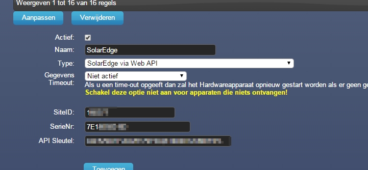

Hi ..
I'm on 2.4623 (using JumboTroll's synology package)
I've added the SolarEdge via Web API but no devices show up.
The used site id / serial / api key must be correct because I used them to do some manual API requests in the browser.
(Also there are no error in the logs; only SolarEdge API worker started)
Can anybody give me a hint on what is causing the devices not to show up?

Things to check you have really got the ids right and the sun is outyvoswillens wrote:Can anybody give me a hint on what is causing the devices not to show up?
More likely, have you allowed new devices in settings and have you transferred the devices into the utility / temperature pages - Setup/Settings accept new devices for 5 minutes, then Setup/Devices use the green arrow next to the SolarEdge devices to move them to the utility / temperature pages.

I completely missed the allowed new devices.
Thanks for helping out with that!

Got the same problem.
Allowed new hardware for 5 minutes, added Solaredge via Web API
Solaredge worker started
No devices visible in the table.
I'm running beta V2.4768
Rebooted a couple of times as well.

Have you check for the log for any errors?
Is it dark at the moment?
Wait until the sun comes up and then allow new hardware for 5 minutes and the devices should appear.

Got it. It even picked up the data without the device connected.
Thanks.
