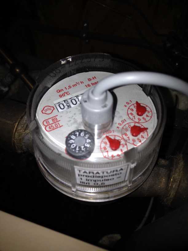

I find it much easier to use a watermeter like this one: (I've been using it for almost 5 years now). It's an Alaxa that I bought somewhere in the Netherlands (http://www.alaxa.nl/). It give a pulse every 0,5l. It is connected to my RFXmeter but it can easyly be connected to a GPIO of your Raspberri Pi or PiFace (If you've got one
- Alaxa
- alaxa.JPG (109.38 KiB) Viewed 12958 times
