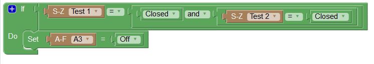

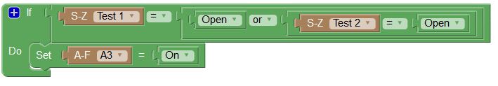

I have two contact switches. If one of them is "open", I want Domoticz to switch on a light. If they are both closed, the light must be switched of. I have 2 blockies, but they are not working. What am I doing wrong?

This isn't really a Domoticz issue, you would find this easier if you had a play with blockly itself and then made your Domoticz event.
https://developers.google.com/blockly/
Your event as written means:
Test 1 = (open or (Test 2 = Open))
not what I think you want which is
(Test 1 = open) or (Test 2 = open)
To get the second you need to add the blocks in the right order not just add left to right as you have done in your code.
So first add if block, then put the or block inside it, then put = blocks on each side of the or block, then fill in the variables and on / open etc..
You should then find your events will work.

Thx for the reactions. I checked is and "Open" and "closed" are right.
Mr simonrg: You put me in the right direction. For "Open" I now have the following Blocky, wich is working now:
Thnx for that. Now to figure out how to handle "Closed"

I think your blockly, as shown in Testopen.JPG, is not built the correct way. Simonrg has explained it well, I want to make it a bit more visual:
First make seperate statements for each thing that needs to be true. In this case you want to check Test 1 and Test 2. So build those 2 statements:
Then combine them in the 'or' statement:
Then take an 'If' block, create a 'Set' statement and there you have it:
And finally you create this:
When you read the text, you will say it sounds exactly what you did in Testopen.JPG, but there is a difference. ;)

mrf68 wrote:I think your blockly, as shown in Testopen.JPG, is not built the correct way. Simonrg has explained it well, I want to make it a bit more visual:
Great job of visual explanation.

The equivalent Lua code would be:
-- /home/pi/domoticz/scripts/lua/script_device_tester.lua
if devicechanged["Test 1"] or devicechanged["Test 2"] then
    if (otherdevices["Test 1"] == "Open" or (otherdevices["Test 2"] == "Open") then
        commandArray["A3"] = "On"
    elseif (otherdevices["Test 1"] == "Off" and (otherdevices["Test 2"] == "Off") then
        commandArray["A3"] = "Off"
return commandArray

You' ve made it very clear. The blocky' s are working now.
Indeed, it looks simple, but if you make a mistake, its hard to find the mistake.
