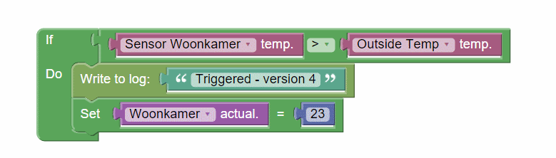

Before I make this a bug report, I'd thought I'd check.
My Smartwares radiator valves that I am using quite easily, don't show up in blocky. I mean, they are listed, but only as switches or utility, and in an event they do not update. So, I have this very simple event;
But although it triggers, it never changes the value of the smartware valve. If I set it manually via the utility tab in the web interface, it works just fine. Is this something I am doing wrong? Or should the radiator be available as radiator?
