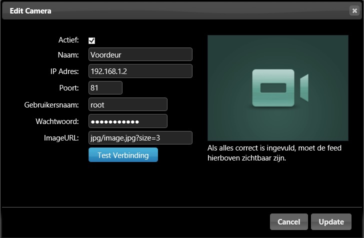

I can`t get my old Axis 207(W) camera working with Domoticz. I have found the url on this forum and this should be: http://camera-ip/axis-cgi/jpg/image.cgi
When i use this url in the browser it works fine but when i add this to domoticz the image appears one time for 1 second and then it changes to black. I also tried to changed the camera settings with anonymous login, but still no luck. I hope there is someone also useing a Axis camere to help me out.
- 2016_01_20_20_18_38_Domoticz.png (21.83 KiB) Viewed 4506 times

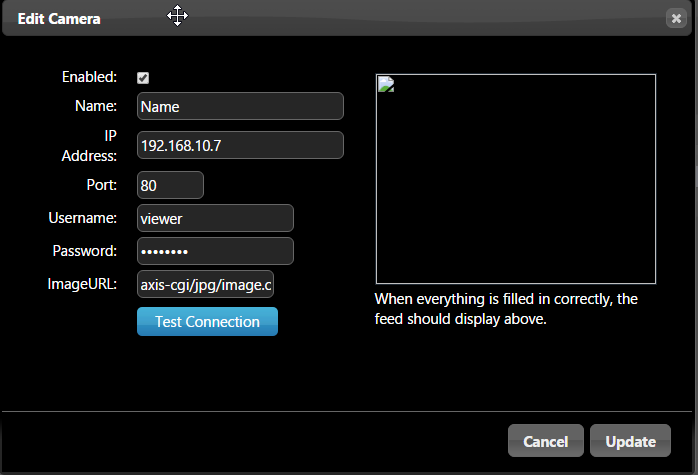

This is my setup with a Axis M1054, maybe try the root user ?mxpwr wrote:That doesnt work either.
When I use the url in this form, I get an image in the preview, but in domoticz I only get a black frame.
/axis-cgi/jpg/image.cgi?usr=root&pwd=pass
- Naamloos.jpg (51.93 KiB) Viewed 4420 times

Re: Axis 207W Image
I see the same problem. If I do test connection with /axis-cgi/jpg/image.cgi it just flashes my snapshot and then returns to broken camera. And downloading doesn't work either.
If I use /jpg/image.jpg?size=3 the test connection works fine but not downloading.
has camera preview been changed recently?
