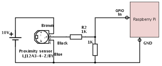

I don't use piface, just raw GPIO pins.
Afaik, they don't have internal pull-up/down resistors, but in the circuit displayed below I would think that the signal is stable in any state, and within the voltage limits of the Pi. Or am I missing something?
Note: This is an unverified schematic, do not use this
Btw, after-care of dx.com is pretty impressive; they've already sent me a free replacement sensor in response to my negative review.

Hi Sebastian,
Ah! That explains. I checked these pages which show you could indeed use a simple divider.
BUT:
- GPIO input is active at 3.3V. A voltage higher than 3.3V should never be applied. See specs here. So the divider should be more like R1= 1k5 Ohm and R2= 560 Ohm if 12V is applied to the sensor (or R1=2k and R2=1k at 10V).
- Also GPIO have configurable 50K pullups to either 3.3V or Ground (see specs above)
- A mistake is easily made so i strongly suggest in having both circuits (using different voltages) isolated. A simple € 4 reed relay could save you a €35 Raspberry Pi.
/paul
