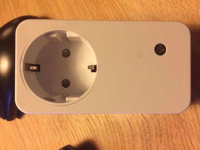

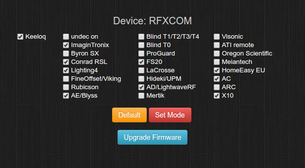

I bougth the Intertek 75.006.1455010x10 switch at the Action. Unfortunately I cann't get it to work. the screendump from the RFXmgr is:
5-2-2016 20:40:02
Packettype = Lighting2
subtype = AC
Sequence nbr = 0
ID = 0288402 decimal:2655234
Unit = 1
Command = On
Signal level = 7 -64dBi
5-2-2016 20:40:03
subtype = HomeEasy EU
Sequence nbr = 1
ID = 0008666 decimal:34406
Unit = 1
Command = On
Signal level = 5 -80dBi
I tried sending the HomeEasy Eu and th AC commands seperately but that is not working any clue how to solve this?
Action Intertek 75.006.1455010x10 switch RFXcom

Re: Action Intertek 75.006.1455010x10 switch RFXcom
Use Ext2 firmware and configure an IT On/Off module in Domoticz.
The PROmax and FA500 use only the IT protocol which can be transmitted by the RFXtrx433E - Ext2 firmware.
The remote transmits 3 protocols, IT, AC and ARC. IT is received by the RFXtrx433E as Lighting4 but this could not be used. The AC and ARC can be used to detect the remote but the module can not be controlled by AC or ARC!
For a FA500DSS dimmer configure an IT Dimmer module in Domoticz.
