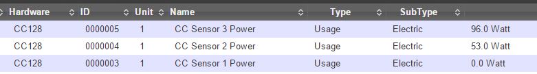

I've updated my Dz with yours and all seems to be ok now. I've got my 3 new sensors ( as i have 3 IAM)
I will have a look tomorrow.
Great job John.
PS : 0 watt for the sensor 1 is normal ;)
