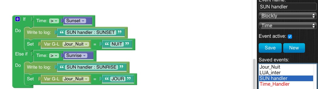

Hello in the above sample I can't understand why the if block is executing, and just after the else if executes too ?
and here is the log that shows the problem :
2016-01-22 21:39:00.428 SUN handler : SUNSET <====================================
end ngRepeat: item in filtered = (logitems | filter:filterExpr) track by $index
2016-01-22 21:39:00.429 EventSystem: Event triggered: SUN handler_1
2016-01-22 21:39:00.430 SUN handler : SUNRISE <====================================
end ngRepeat: item in filtered = (log items | filter:filterExpr) track by $index
I'm sorry, i'm a starter with Domoticz and I'm sure I'm missing something
Pascal

that's because when it's later than sunset, it's also still later than sunrise ;)
You should do the following:
If [Time > Sunset] or* [Time < Sunrise]
Do [Set var Jour_Nuit = "Nuit"]
Else if [Time > Sunrise] and [Time < Sunset]
Do [Set var Jour_Nuit = "Jour"]
* Domoticz sees every time related event from and to midnight. So if you're crossing midnight with an event, you'll have to use 'or'

I understand your answer, however, as far as I understand the "ELSE IF", this block should not execute if the "IF' block just executed ?
IF this is SUNSET ... set variable to "NIGHT" (NUIT in french) and quit ...
I'm missing something here ...
Please can you help me

it triggers just fine, no need to worry ;)
Even better is this to prevent retriggering:
If [[Time > Sunset] or* [Time < Sunrise]] and [var Jour_Nuit = "Jour"]
Else if [[Time > Sunrise] and [Time < Sunset]] and [var Jour_Nuit = "Nuit"]

But, I think the "ELSE IF" block should not execute if the "IF" block has executed ? Am I wrong ? Who can explain me that point ?
If I'm wrong, what is the "ELSE IF" utility ? this is something I don't understand here ...
Thanks for your help

You are wrong ;).
see here for instance
the If-statement as well as the Else if-statement will trigger when conditions are met

Did you read what it says?
An if statement follows this sort of structure:
if (condition) {
// executed only if "condition" is true
} else if (other condition) {
// executed only if "condition" was false and "other condition" is true
} else {
// executed only if both "condition" and "other condition" were false
As it says: executed only if "condition" was false and "other condition" is true

Yes I read what it says :
In my case, if (condition){
} is just true, it's 2016-01-22 21:39:00.428, so "IF" block is executed SUNSET, thats OK ...
BUT after I read :
I read executed only if "condition" was false ... I think I understand ... So, if "condition" was true as seen above ... SO I UNDERSTAND the "else if" block should not execute ...
where am I wrong ?
later in the provided sample I read this :
/* If-ElseIf-Else Example */
if(condition_is_true){
do_this
}else if(different_condition_is_true){
do_this_only_if_first_condition_was_false_and_different_condition_was_true
I'm still blocking on your "explanations" … please

Sorry pcardon. I wasn't clear. I mean that you are right with your problem. And tozzke made mistake.

Thanks for your answer … does that mean there is a bug in the Blocky script engine ?
Is it possible to have a so big bug ?
Can somebody test on his Domoticz and see if he has the same problem …
I'm running Domoticz on a Synology, perhaps it's a specific problem to this distribution ...

It has always been this way. It would be better if the name ELSE was not there. Because it only functions as IF, then.. IF, then etc.
This was the reason I switched to LUA scripting. When you want to solve it in Blockly you have to make large scripts which are sometimes hard to debug. To have one ELSE statement, you now have to copy your whole Blockly and add one different parameter so it will only trigger then.

bizziebis wrote:It has always been this way. It would be better if the name ELSE was not there. Because it only functions as IF, then.. IF, then etc.
Thanks you for this explanation …
So you know why I didn't understand … and that is different of all other "else if" implementations I ever seen

I also discovered another bug, like in this code:
If button = On
Do
  If light = Off and a = 0
  Do
    Set a = 1
    Set light = On
  Else if light = On and a = 0
  Do
    Set light = Off
  Set a = 0
In this example not only Else executes but also (if light = On AND a = 0) executes despite the 'a' was set to 1 in previous statement!
What's going on?
Domoticz, is this really kind of joke? This is not funny.
