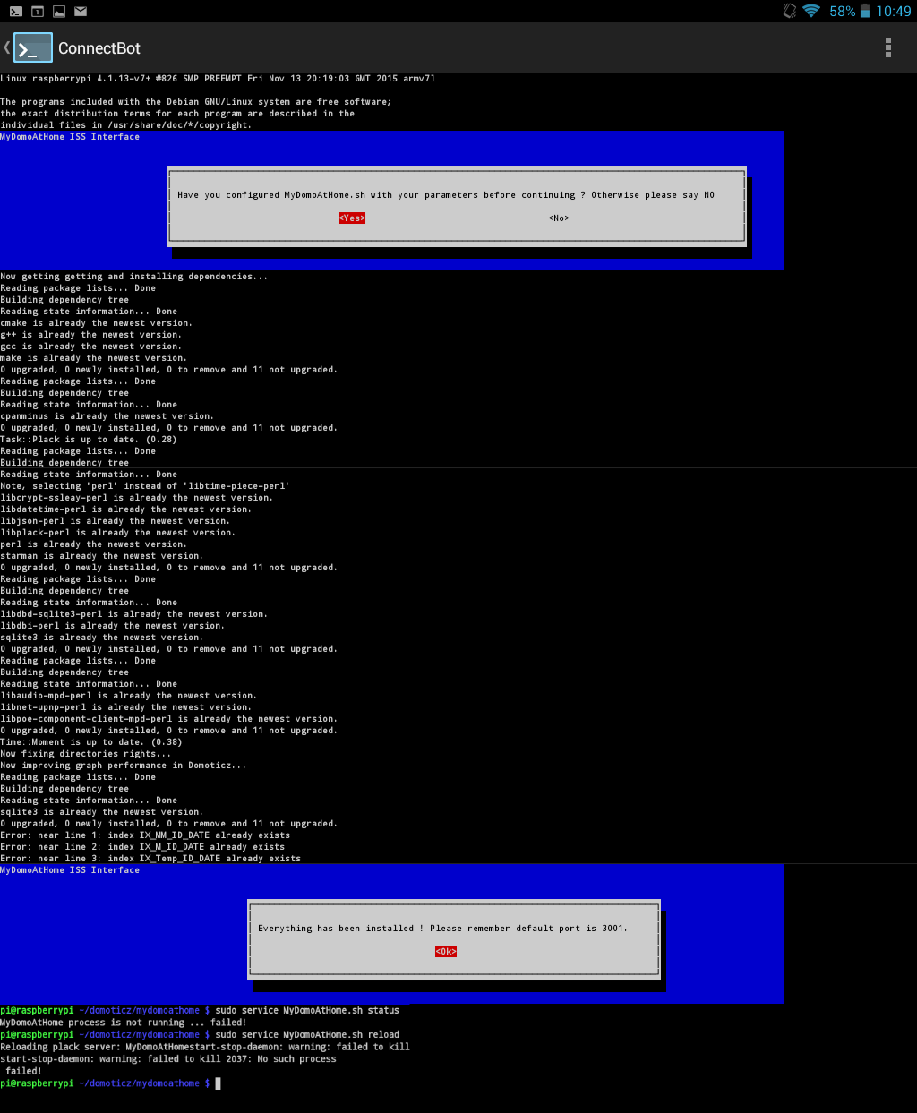

screendump
screendump
Putty run-once.sh.PNG (30.5 KiB) Viewed 6184 times
<bump> ;)
This is the line
sh ./run-once.sh
is stuck all the time. Any other suggestions?

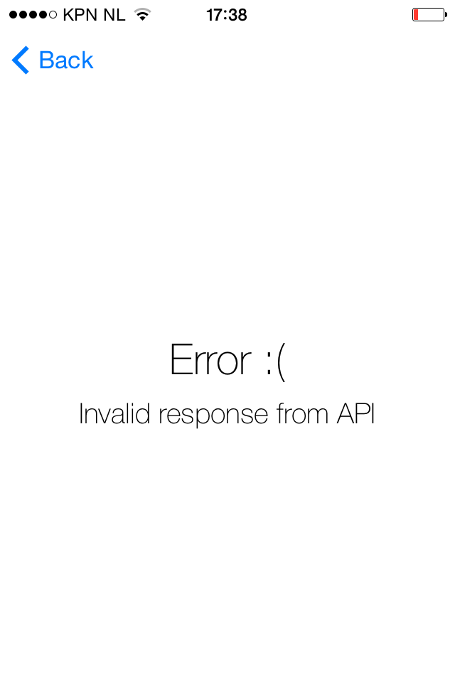

The Imperihome still cannot connect "Error :( Invalid response from API". Any suggestions?

Would you please copy the right config files as an example? I'm still struggling with the installation. I've formatted my SD-card and re-downloaded the Domoticz image file. After re-installing all the steps unfortunately still no luck.
Now I've got the message:
MyDomoAtHome process is not running... failed!
and
No such process
