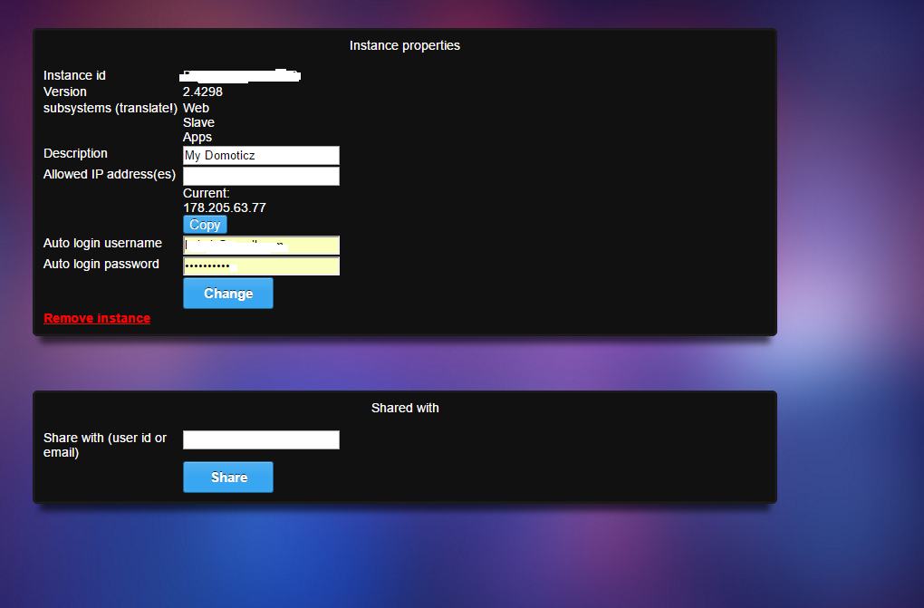

You can see it after you log in at https://my.domoticz.com/.sclk34 wrote:Hello!
I'm a novice. And I did not understand the information from Wikipedia about my.domoticz.com.
I share the instance, but how to use it ? How to see the Web Interface of domoticz server?

All that I can see on this site (see the attachment). how can I go to my devices?
- 2.png (355.13 KiB) Viewed 4019 times
- 1.png (363.45 KiB) Viewed 4019 times

You can click on the green icon and you will have access to your Domoticz.sclk34 wrote:All that I can see on this site (see the attachment)

Its work))) but it is not obvious. Thank you!
