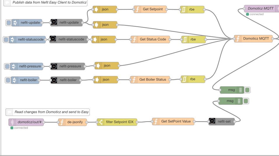

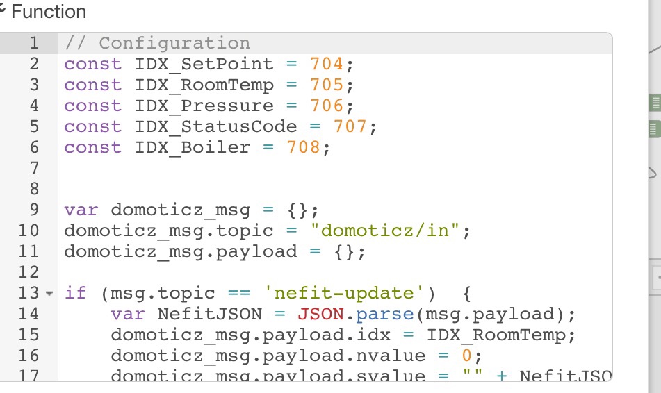

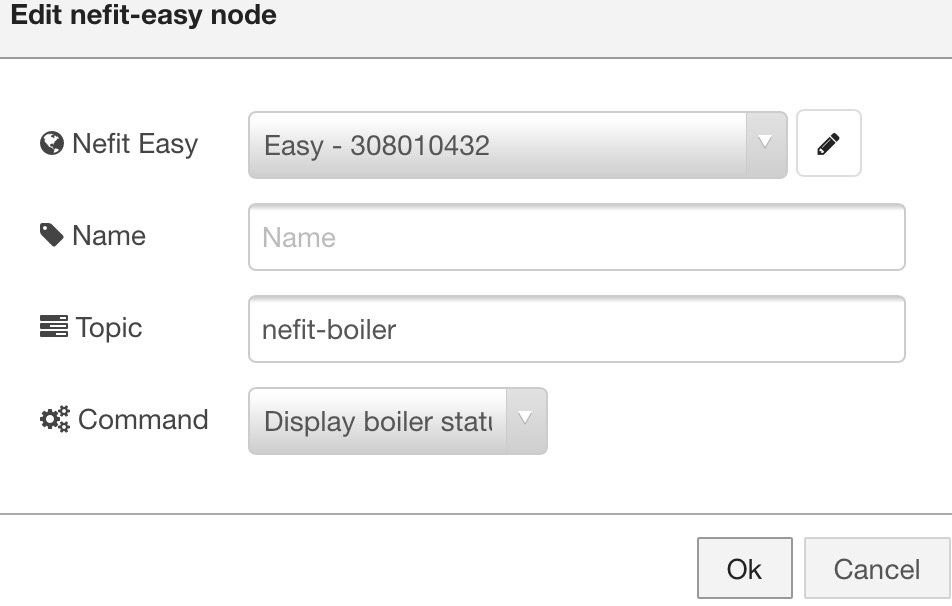

How do I modify the flow?pepijn wrote:Do you want to set this function? You can read already, you just need to modify your flow the nefit status node show 'fp active' and 'fireplace mode'geezerrr wrote:The "openhaardfunctie" would be nice as well
I've added the boiler status to find out how the node-red is working. but it's not giving an output to Dominicz so far
I've did it like this...
Can you point me in the right direction?
- ImageUploadedByTapatalk1453067661.577496.jpg (128.64 KiB) Viewed 5351 times
- ImageUploadedByTapatalk1453067654.123833.jpg (59.53 KiB) Viewed 5351 times
- ImageUploadedByTapatalk1453067640.986491.jpg (93.37 KiB) Viewed 5351 times

In this version of the flow (there is a more recent version in one of the previous posts) you need to create an extra if statement Domoticz MQTT function.

Found it, and it's working! Thnx!pepijn wrote:In this version of the flow (there is a more recent version in one of the previous posts) you need to create an extra if statement Domoticz MQTT function.
