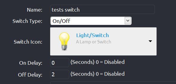

I have several Kmtronic ip relays. How can I create I button on my relay so I make a rising edge, I want to command something that just need a signal and not and continuous On state.

Re: Rising edge KMtronic ip relay
I use the USB 8 relays card from kmtronic.
For the IP, I think you have created the hardware Type : KMTronic Gateway with Lan Interface ?
Test this for an impulse of 2 seconds :
