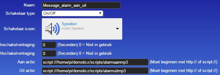

Now comes the part I got stuck, I've made a dummy swith and put the command in the "on" part of it (did the same for "off", but this has the same results):
In the log I see the script got activated, but no sound.
