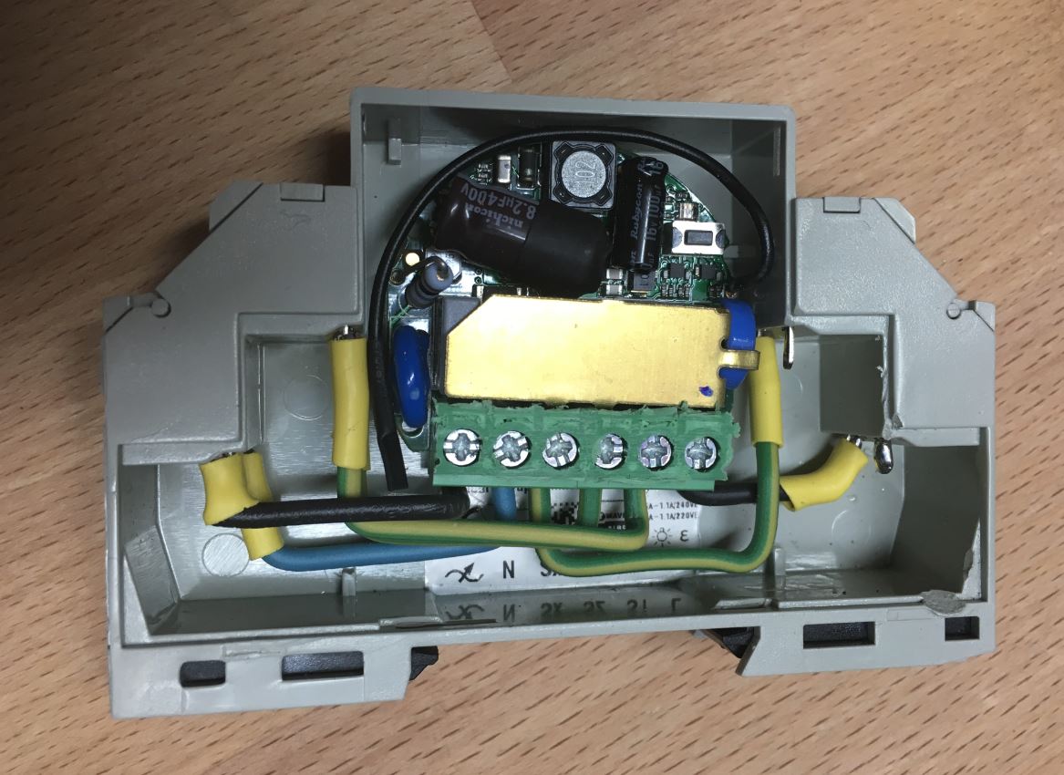

I integrated a Fibaro Dimmer 2 into an empty DIN Rail housing (german Hutschiene) for mounting in electrical Distributor box.
I removed the cover from Dimmer 2 and had to cut the plastics (green) of the connector a few millimeters to fit inside.
