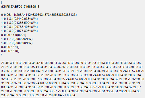

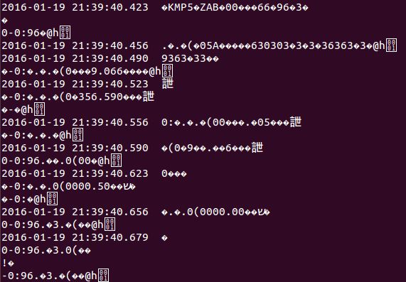

I originally posted an issue with reading my P1 meter in domoticz.com/forum/viewtopic.php?f=14&t=4970. That was a while ago (June last year) but I wasn’t able to solve the problem back then. I hadn’t had a chance to look at it again until last week but I think I’ve come a bit closer to the solution now. I haven’t completely figured it out though and was hoping someone could help me.
My smart meter is a Kamstrup 382JxC and I am using a HL-340 USB to RS232 Serial Port Adapter Cable (from dx.com) to connect the smart meter to a pc running domoticz (on linux). I use a baud rate of 9600, which is the correct value based on some testing with a serial port reader. Domoticz doesn’t give me any meter reading however so I decided to have it output the strings it gets from the meter, see the figure below.
Screenshot from 2016-01-19 21_40_49.jpg (46.85 KiB) Viewed 7497 times
As you can see (ignore the time stamps) it gets some sensible numbers, but there are also some weird characters. This surprised me since I used Bray’s terminal on Windows to look at the meter readings and they seemed normal:
(the figure gives both the ASCII and the HEX output). I then did the same thing with a serial port reader for Linux and got this results:
Screenshot from 2016-01-19 21_42_35.jpg (29.69 KiB) Viewed 7497 times
So this reader recognizes the same characters as domoticz and doesn’t recognize the ones where domoticz displays a weird number (in other words, the problem doesn’t seem to be domoticz). If you look at the HEX representation it seems that the weird characters are the ones where the HEX representation under Windows differs from the one under Linux (1 for example has HEX code 31 under Windows but the reading under Linux is B1). I don’t understand this. How can I get different readings under Linux and Windows? Is there a problem with my Cable?
It seems that the problem is solvable by substituting HEX code AX by 2X, BX by 3X, and CX by 4X (where X=1,2,3,…), which I think I could do in the domoticz code, but I don’t know if that’s the right way to go (it seems more of a hack instead of getting to the root cause).
Peter

Could it be that the 'Bray's terminal' software inverts the data? For my meter it was needed to solder an BS170-transistor + 10K resistor in the dataline (see my topic under 'Meters' subforum) to reinvert the data to a readable format.

What I think is your issue is your setting.
0x31= 00110001
0xB1= 10110001
it looks like it is trying to decode 8N1 where it should be 7E1.

Thanks bbqkees, I figured I was the only one since I haven't seen any other posts about this. I thought my cable was ok based on the readings under Windows so that's why I didn't buy a new cable. But maybe that was the wrong conclusion so I'll just buy a new cable. I did spend a few evenings on this but I also learned some stuff so it wasn't completely wasted :-).
Thinkpad, thanks for your reaction. Based on the fact that some numbers are correct under Linux while others are not I think it's not an inversion problem but, as bbqkees suggests, a problem with a misinterpretation of the parity bit.
I'll post an update when the problem is solved.
