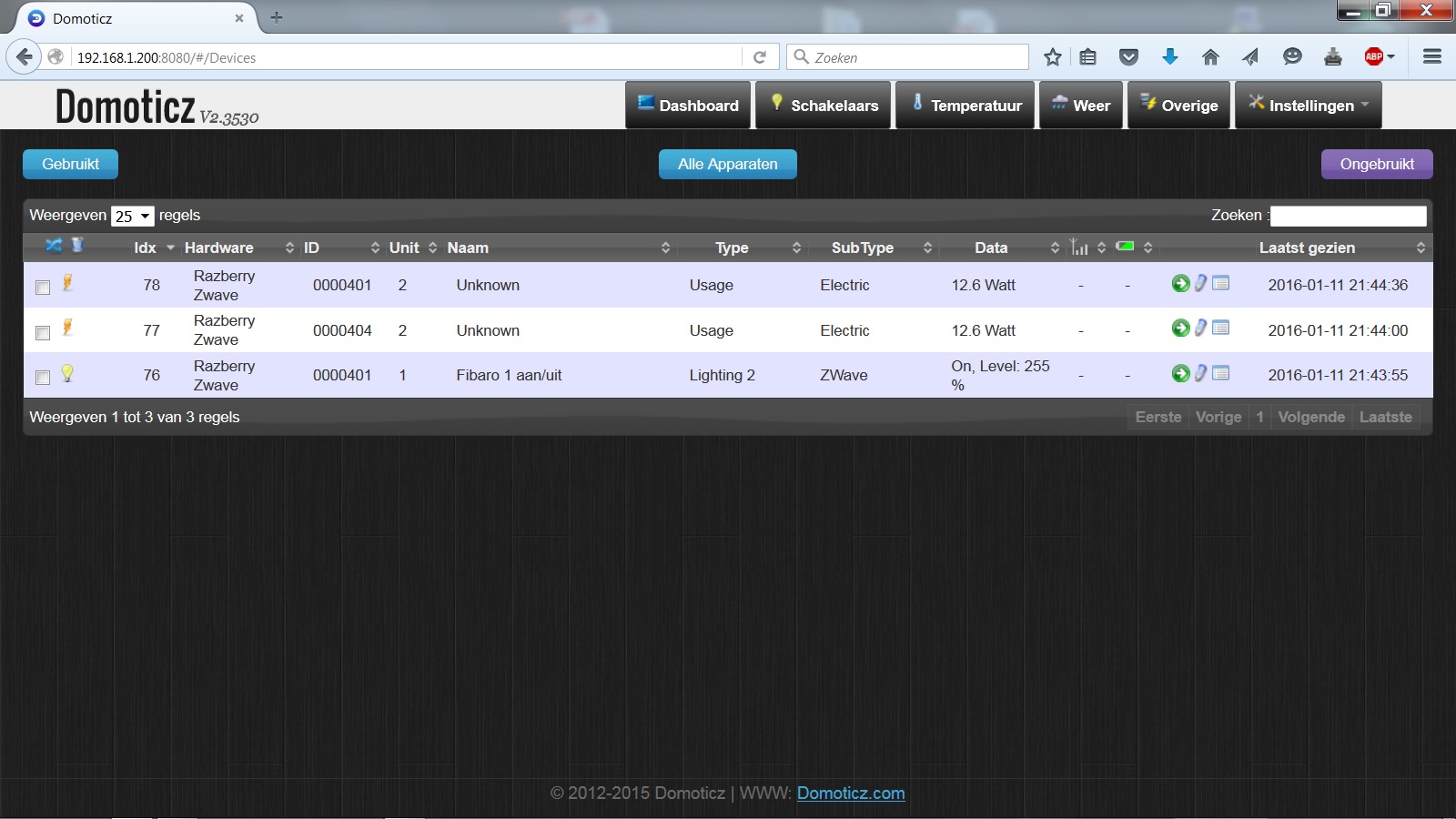

I am on Domoticz 2.3530 and trying to get a Fibaro Wall Plug FGWPE (sold as "Toon Stekker" to be exact) working corretly....meaning: also being able to see energy consumption in Domoticz.
What is going well: associatoin with Domoticz as a node.
What does not look well: I only get three devices instead of the four I expected (see attached).
The two usage devices do not provide me with the cumulative energy consumption in kWh that I would like.
Am I doing something wrong here?
Any help is appreciated.
Michel.

Shortly after my posting here, I performed a reboot of my RaspBerry Pi....after the reboot all 4 devices were available in Domoticz.
Serendipity and case close!

yes, some devices are slow to appear or they only appear after they have been triggered(eg kwh is triggered after 0.1kWh)
a stop and start of domoticz will also help but you have 2 wait after domoticz has started because it is initializeing Z-wave for a while
